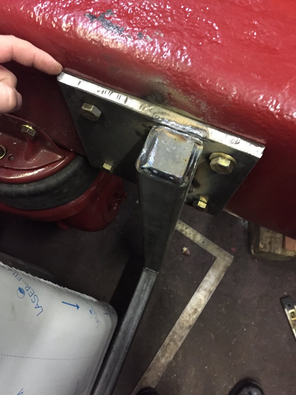

    You could:
    Spin the nuts off the front suspension bracket, replace with longer bolts, and make a drop bracket bar off that coming down to the bottom to hold the base of the fender.
    This is the one for my half fenders- which I realize isn't the same at all. I don't have any pics handy of the center brackets on my other truck with the full fenders, which are a lot more similar to what I'm trying to describe for your setup. I'll see if I can remember tomorrow to snap a pic of them.
    sawmill, SAR, Oxbow and 10 others Thank this.

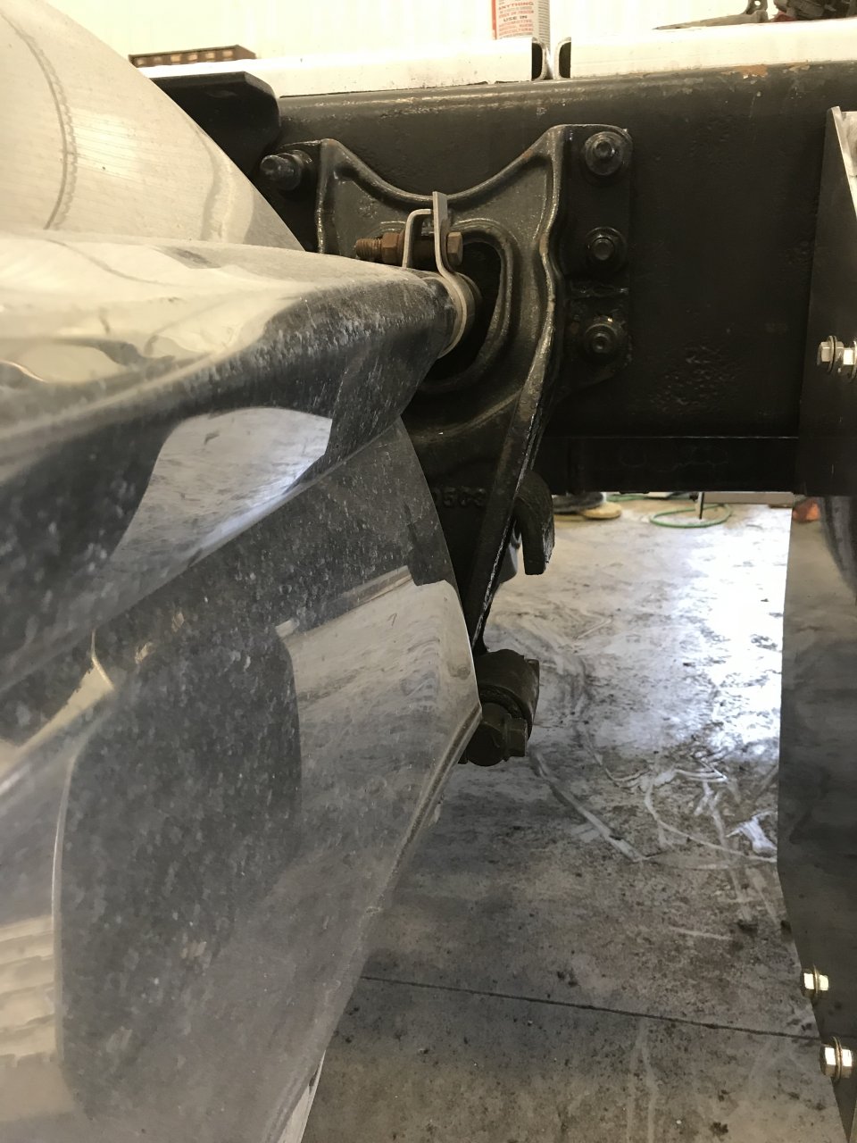

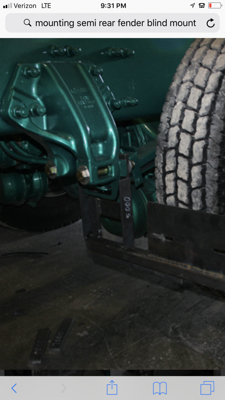

    Yea when I first thought about blind mounting them I remembered seeing your mount and was thinking I could just do the same?.......nope
    I’m not sure there will be enough room between the bracket and the fender? If I mount off of those 3 bolts holding the bracket I will be in front of the fender unless I angle it back or step it back?
    I’d love to see a picture of your other mount!

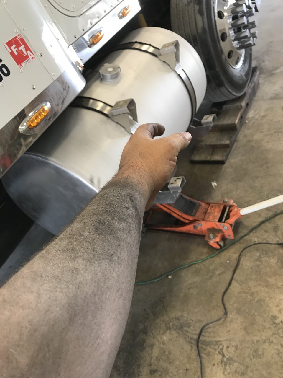

    What’s wrong with your truck?
    4mer trucker, SAR, Oxbow and 5 others Thank this.
  7. Gumper
    Gumper Road Train Member
    1,579
    3,847
    Jan 7, 2018
    Butte, MT
    Pinion bearing on the rear rear is shot. Can grab it and wiggle it in any direction half an inch. It carried me to drop off the load, and that’s all I needed.

    Your FINALLY getting to that passenger tank, lol.
