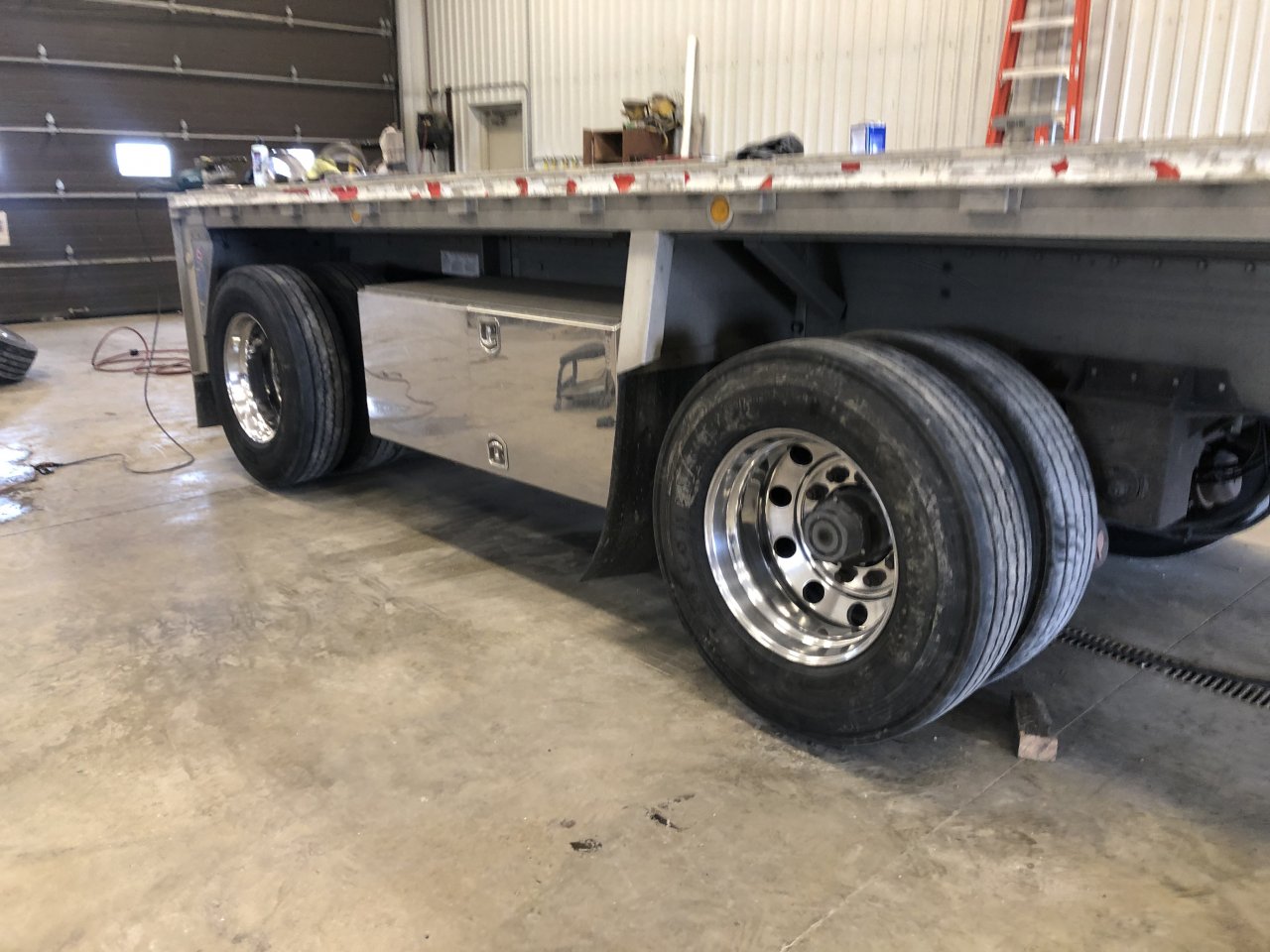

    My trailer had boxes in both locations when I bought it. The ones in the center were in much better condition than the ones between the spread. I think the ride is better in the center of the trailer and the doors don’t get all banged up. 64B65F98-CDDB-4534-BB66-E58721A8F0C0.jpeg But it looks a million times better between the spread.

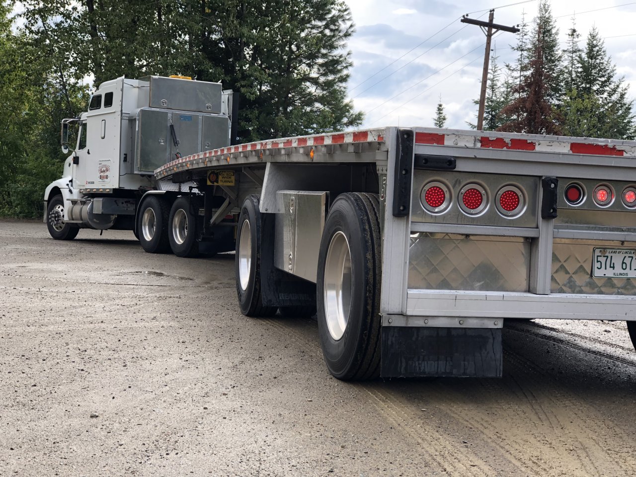

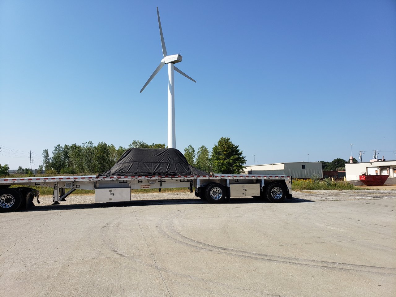

    I have 3 on my Reitnouer. 2 between the spread and then one in the middle. I would say it's pretty much personal preference where you put them. 20180921_113018.jpg

    It does look nice! He is right, if you blow a tire, there goes your $700 box
