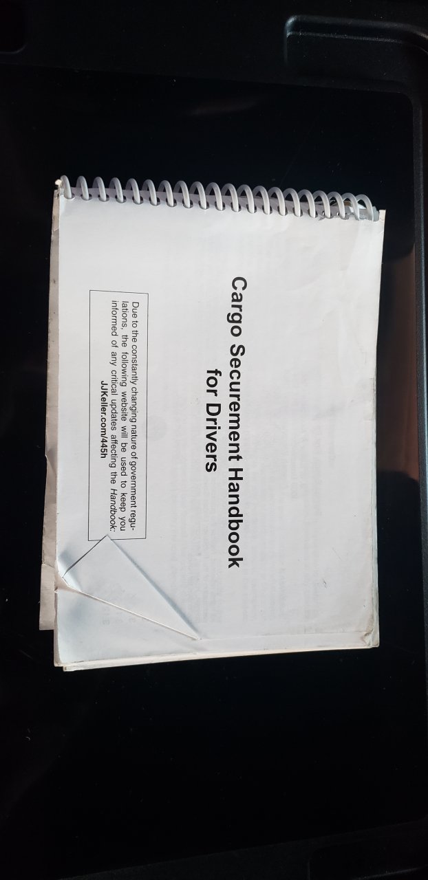

  4. JonJon78
    JonJon78 Road Train Member
    7,248
    43,442
    Jul 1, 2018
    Western didn't provide you with one of these during orientation? If not get one. 15921500991291919691778892862377.jpg

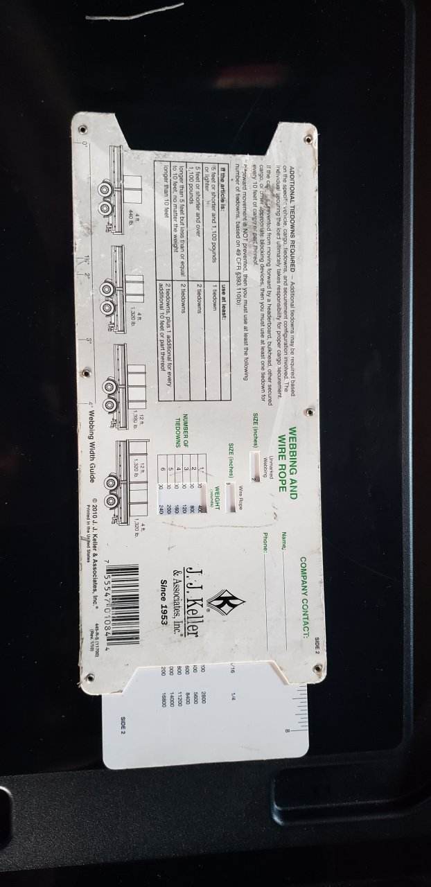

    Another good thing to have is this
  5. farmerjohn64
    6,383
    38,746
    Jun 25, 2019
    They gave me that handbook and I’ve been reading it; what’s the second picture of?

  7. JonJon78
    7,248
    43,442
    Jul 1, 2018
    It tells you how many tie downs you need based on weight&size for straps and then on the other side it's for chains.
    Basically a quick reference guide.

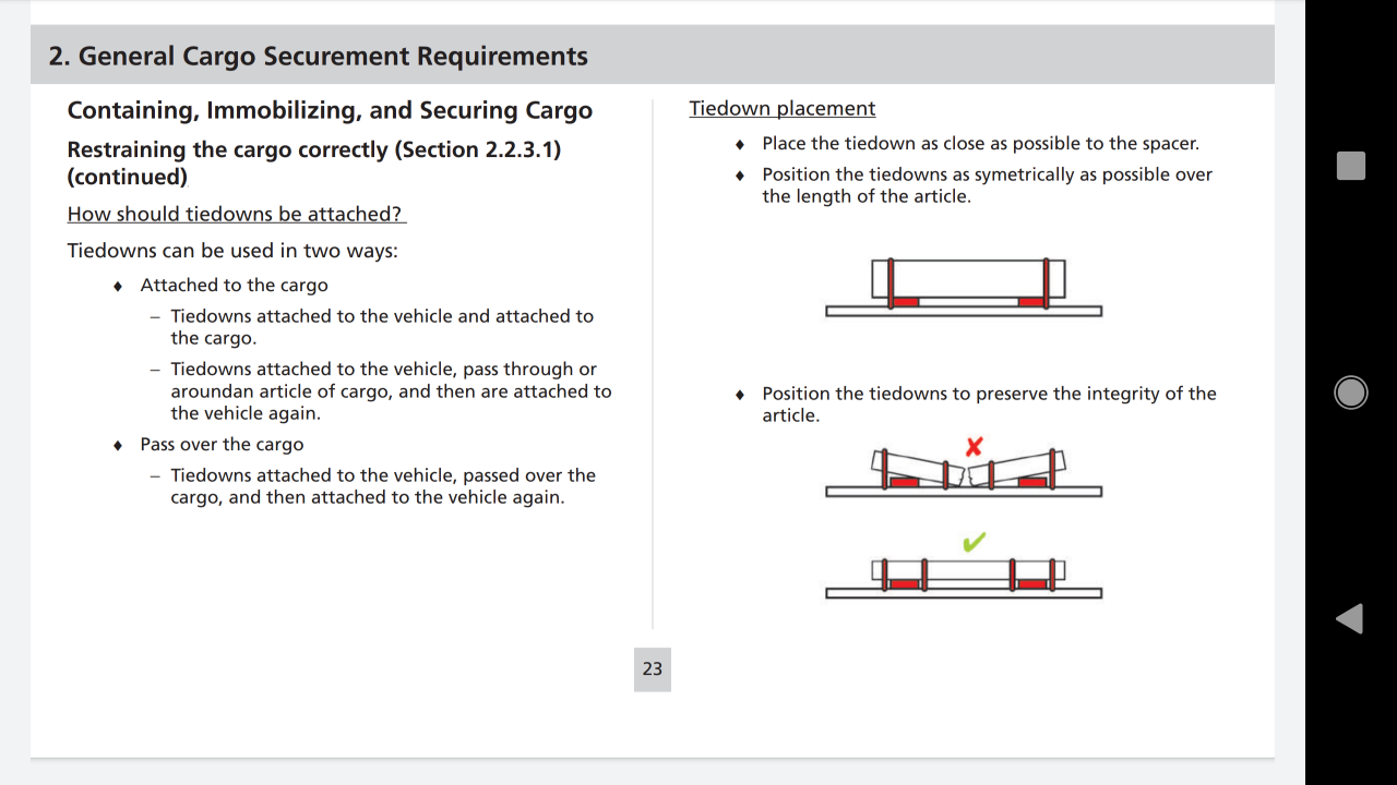

  9. skellr
    skellr Road Train Member
    8,735
    12,187
    Jul 17, 2011
    The Village, Portmeirion
    It helps to look at strapping (indirect tiedown) in a slightly different way. You aren't just throwing straps to hold the load on, you are trying to increase the friction between the load and the deck, it's the friction that will be more effective to keep the load from moving.
    I like to throw straps near whatever part is touching the deck, like the sticker/skids/dunnage. Wherever it will be best to apply friction to all the dunnage in the "stack". Placing straps near dunnage usually let's you apply more pressure without bending the product.
  10. skellr
    8,735
    12,187
    Jul 17, 2011
    Here is an example from the handbook.
  11. farmerjohn64
    6,383
    38,746
    Jun 25, 2019
    The bottom right illustration with the green check mark is what I had in mind, but with the addition of the other two straps
    D.Tibbitt and skellr Thank this.
