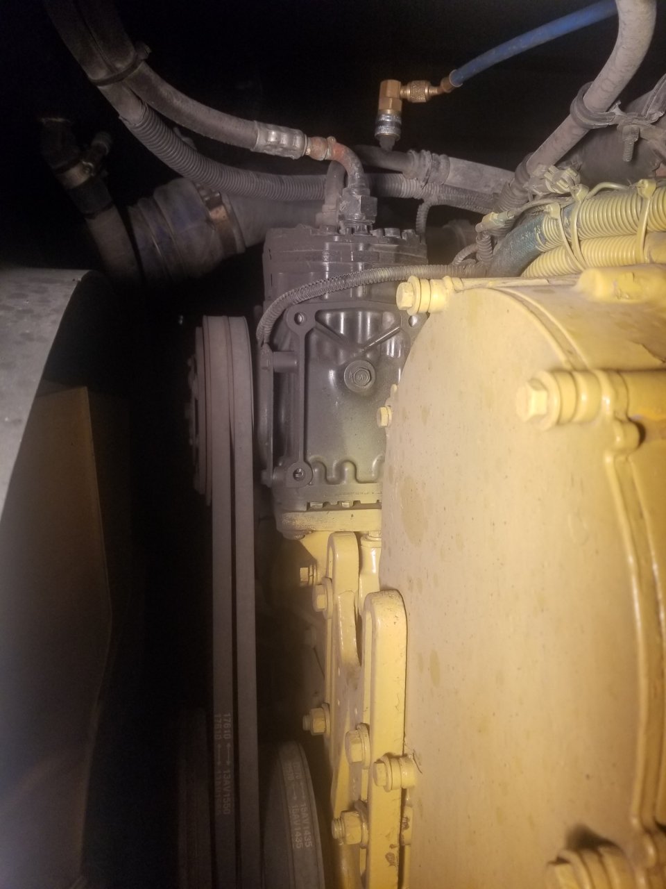

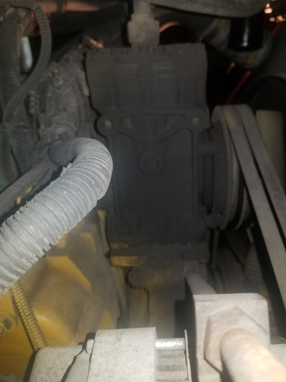

  8. snowman_w900
    4,418
    81,025
    Nov 25, 2010
    Thanks guys. @BoxCarKidd , are these the side plugs you are referring to to check the oil on the Yoke style compressor?
