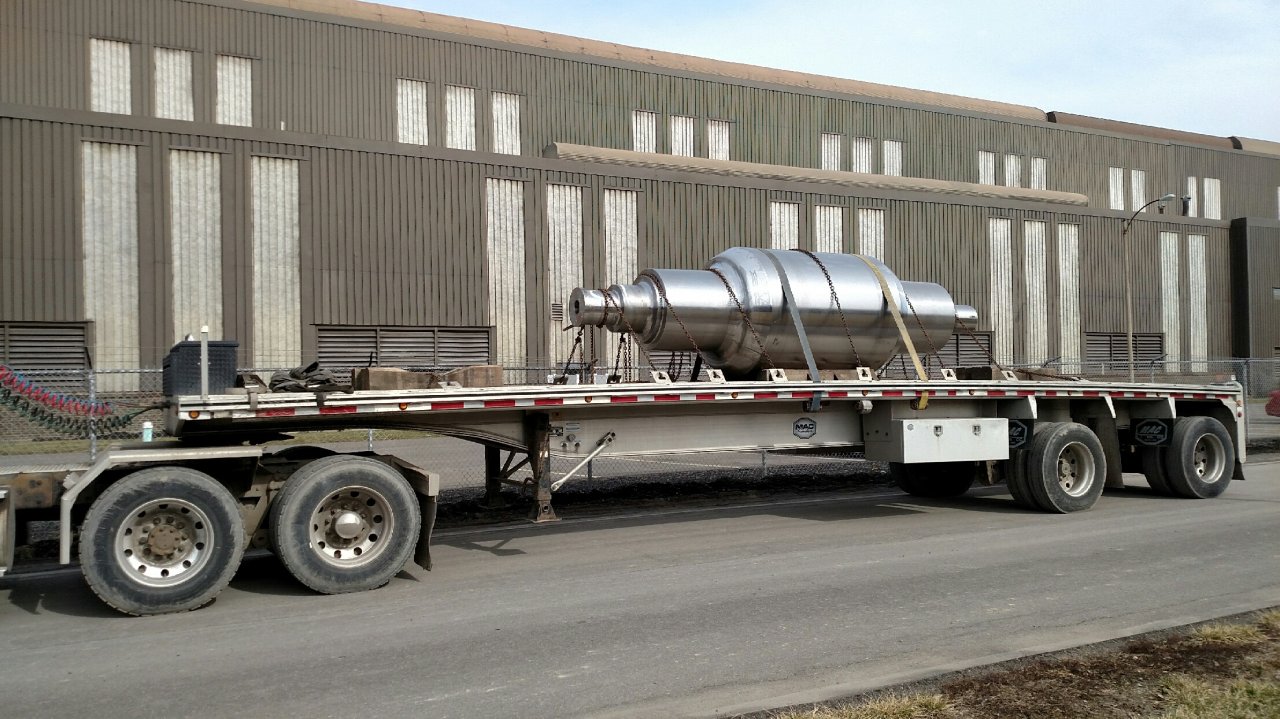

    MAC with the heavier beams. I used to haul mill rolls between plants. I had MAC build a trailer for me a few years back it. It hauled mid 70k mill rolls on a regular basis and seen its share of 80 plus. It always had an arch and in the 5 years I run it it never cracked anywhere.

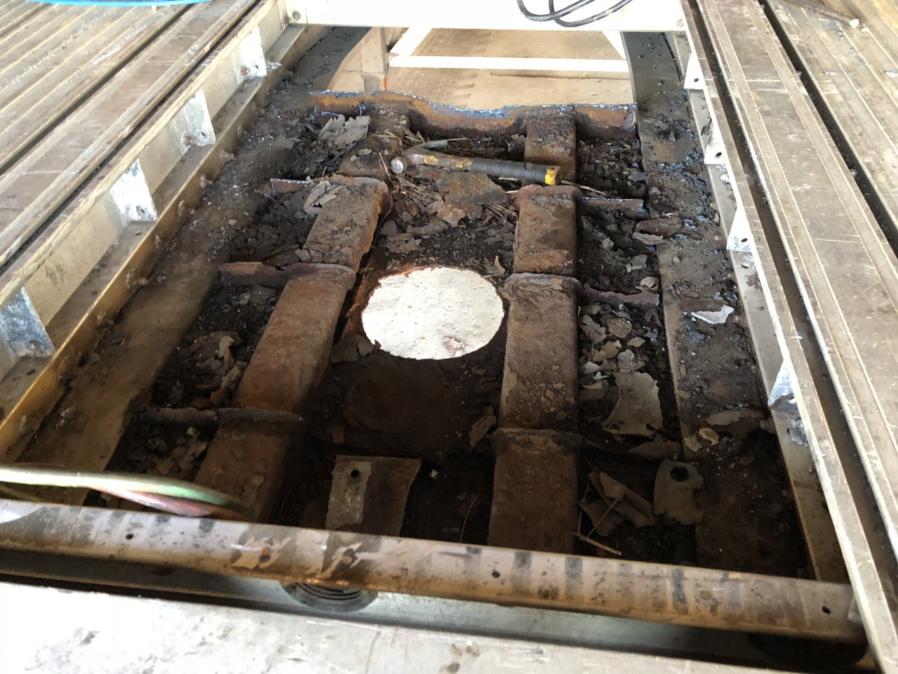

    If you buy a used one, watch out for this though.

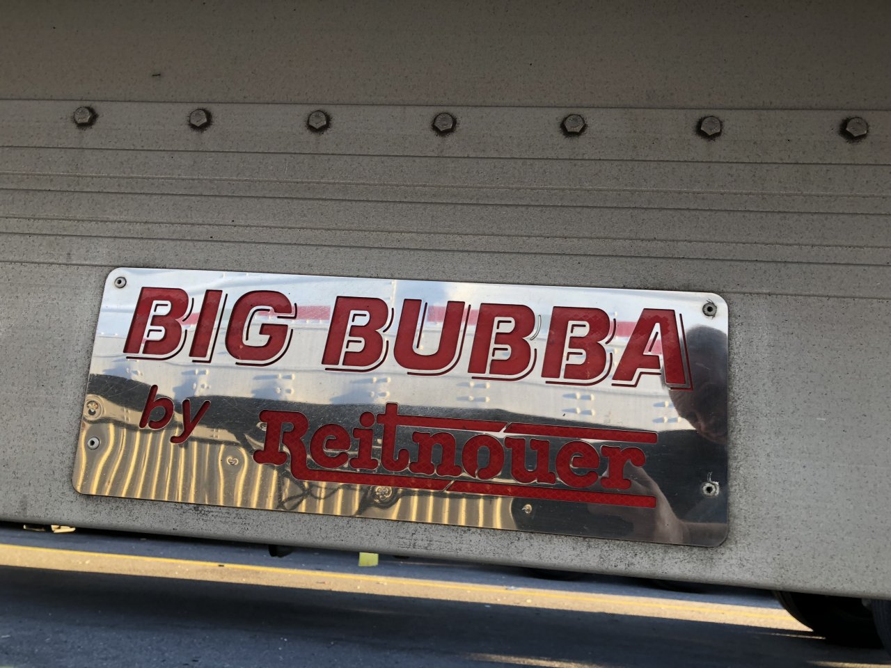

    If you get a fast track. Get either a reitnouer big Bubba or a mac m60 beam. Both are light and stronger to keep your roll tarp tight.

    Loaded next to a guy a few weeks ago. Bought a nice 2013 Big Bubba for $13000,00 because it was a 45’.
    Nice clean well kept trailer. He said it sat on the lot for a year because no one would even look at it.
    It was a nice score. He said he had problems with brokers at first but now he just tells them he has a 48’ and no problems,
