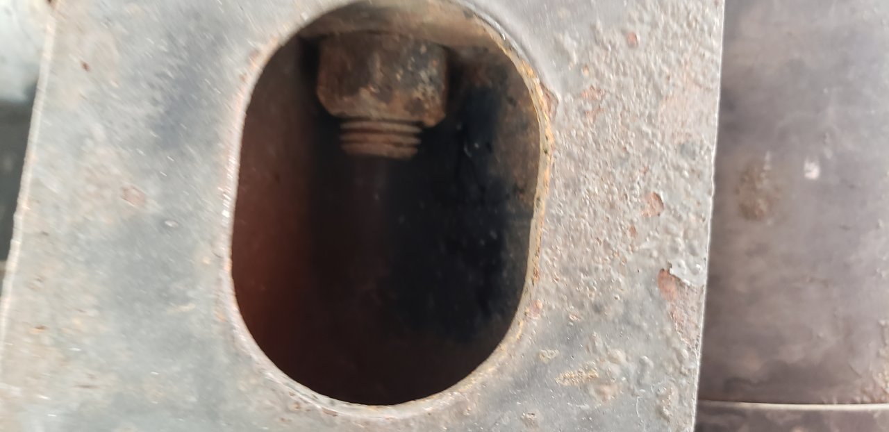

    This is where the bolt for one of my trailer shock absorber goes through. No room to get any of my wrenches around it.... Maybe a crowfoot might work? Possibly angle wrench? Socket won't fit on it...
    Any ideas?

    I have used a pry bar to hold a nut like that and hit the bolt with the impact. I’d recommend putting some heat and a little lube on the threads before you try it.
    @Goodysnap @spsauerland may have some ideas.

    Very shallow socket and thin wall. thin wall box end wrench

    Torch it…… replace with new…. Done.

    Won't fit, no room with that "wall" surrounding the bolt...

    I guess just as long as it's a Snap-On pry bar it will work :rolleyes:

    Did this earlier today with success on one of them but, having issues with this one. Its just spinning when I hit it with the impact need to get some "bite" around that nut, not just on one side...

    I dont have a torch... I would like to get the correct tool Reitnouer uses for this so I'm not running into this issue every time I need these shocks changed...
