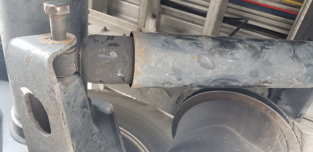

    Not much room at all to get anything inside the hole where the nut is...This a picture from the other side. Was able to get this one out obviously. 20200717_130444.jpg

    Oh, thats easy, use your grinder to cut the bolt flush at the shock on the outside, slip shock off and at worst you might have to cut it closer again

    I was able to change this shock, the one im having trouble with i can't get the nut loose so I dont have that room on the bolt to cut... unless I tried to grind the head... think paying someone to torch is gonna be best option

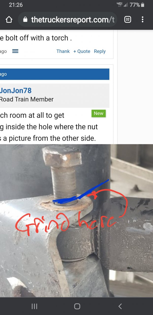

    Even with the bolt close up, its easier to cut at the bolt head then grind flush, make sure you have multiple grinding wheels
    I would cut at a slight angle to aiming to still be able to toss a wrench on the bolt head to shear it (bolt head) off

    Either jam something against the nut, and turn the bolt with a socket, breaker and cheater bar, or take a small cutting wheel, on small grinder, cut the bottom of the shock off, then cut the remaining eyelet of the shock off the bolt, then cut the bolt. I used a cheap 1/4” harbor freight air grinder, ran off the trucks compressor to cut my U bolts. Small enough and powerful enough for that. 4” cutting wheel on a small electric grinder will probably work best. Just cut the head off, if that’s leaves enough room to get nut/bolt out.
