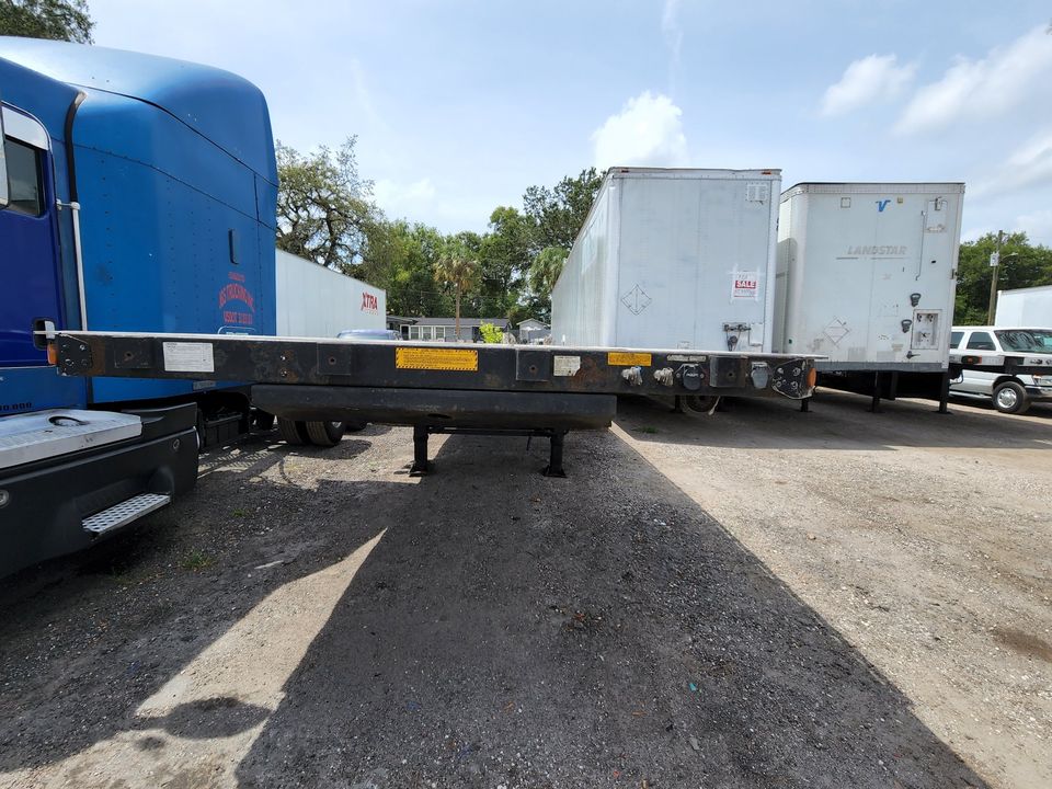

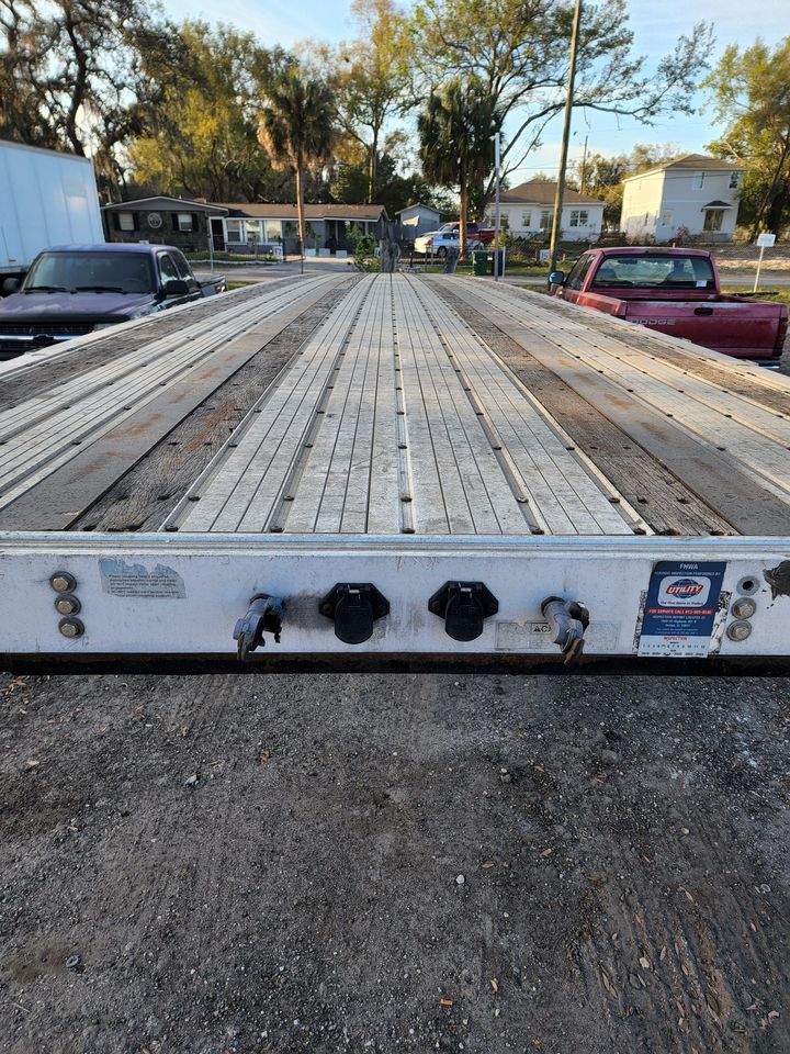

    I run two cords
    A yellow and green. The green is the basic stuff and the yellow is basically extra power for the lift and dump axles and one trailer has extra lights that fired when in reverse for backing

    I added a dump valve on the rear axle so it pivots on the front axle when used. My second receptacle is only
    a four prong and only two of those prongs are being used. Positive to the dump valve and negative back to
    the the tractor (nothing should be grounded to the trailer because the greased fifth wheel will sometimes
    break electrical contact to the tractor).
