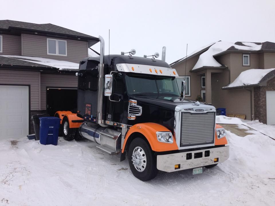

    I got a brand new 2014 Coronado with a DD 15 engine, while I was setting the truck up with all my stuff it was probably running for 4-5 hours and then the check engine light came on and the regen light, so I did a parked regen, took about 40 mins and all was good, then yesterday I drove it 1000 km's and parked for the night, 8 hours and 45 mins later I was woke up by the truck shutting itself off, I went and looked and the check engine light was on as well as the stop light and regen light, so I started it and did a parked regen again, this time it only took about 15 mins and it was good, do I have to do this every night? it's too cold here to shut it off at night, my Volvo would do a regen itself at night if it needed it, can it be set to do it on it's own, we get -30 celsius temps here all the time in winter and a lot of times the truck runs for a few days if I'm stuck in a storm and the roads closed or whatever, thanks for any help, I can count on one hand how many times I did a parked regen on my Volvo.

    Beautiful truck by the way. I have heard that the DD15 is a good engine, I just don't understand them yet and the complexity puts me off; I still have love for the Series 60 I guess. Do you have an APU? It seems that all the current generation engines have no tolerance for excessive idling ( all OEMs ) and my thought would be to have an APU keep the engine and cab warm.

    That is a nice looking truck...wish you the best of luck with it !
