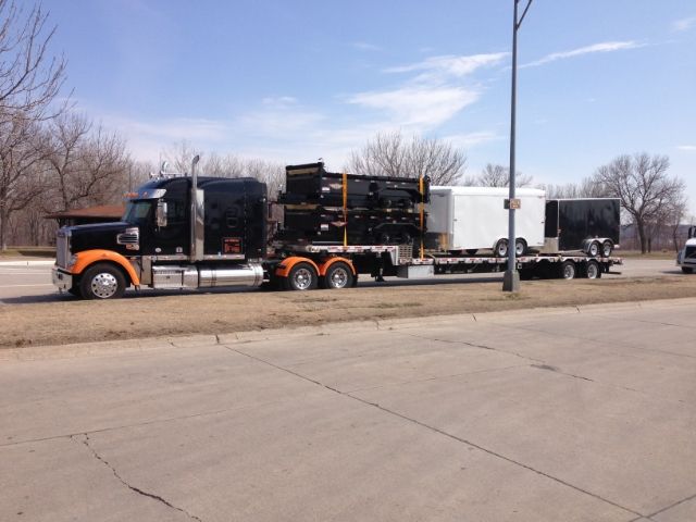

    I stopped at a few dealers this week and no one could fit it in, I talked to my dealer and they said to bring it right in when I get home, few hours to go and I'm off for 4 days so they will set it up, he said they need to idle at around 1100-1200 for our weather, all I can do now is 850, it's been warm enough the last few nights that I've been shutting it off and using the bunk heater, trucks working great otherwise, got 7000 km on it now, here she is with the first load.
    He's gonna set it up so I can take it anywhere from 900-1400.

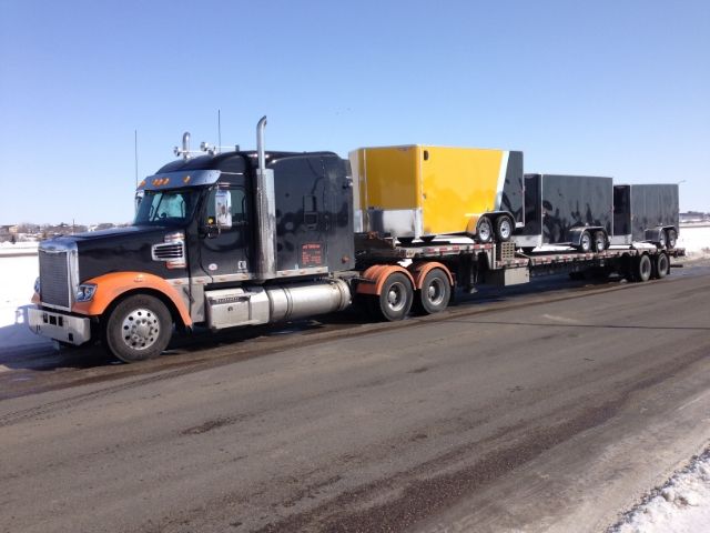

    Got its first wash yesterday, the trailer was more than due, I've noticed a few people this week taking pictures of the truck, lol
