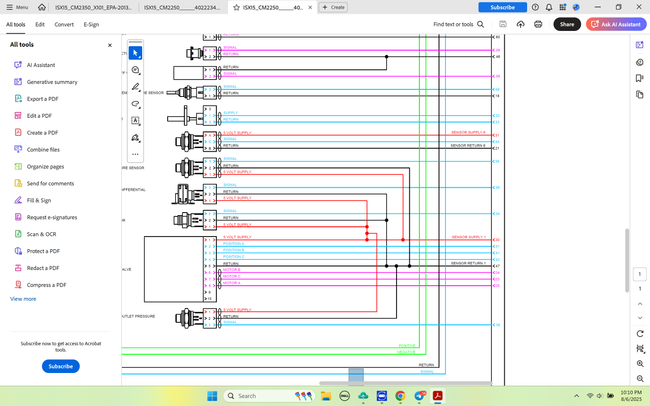

    I have a fluke but tested with my oldie and the sensor was still bad. Just my luck. I did blow out the old sensor and got it to read a value. There is another pressure sensor on the egr valve and that did have resistance. So I worked with everything for a while today. The pink number 30 pin 5v reference wire goes up to a red wire on the egr valve plug on the harness. Makes no sense why it wouldnt be pink there too. Every other wire in that egr plug plug tested .7 volts with the key on including the return. Not normal....so went down to the ecm and test each pin that is supposed to feed that plug.
    3 .8v
    4 .8v
    5 .8v
    30 5v
    41 5v
    42 2.5v
    47 0v
    51 .7v
    Those are the eight pins that are supposed to feed that plug. I tested continuity of all the wires in that egr plug to themselves to check for breaks or shorts and the only 2 that were connected was the red 5v reference wire and the return sensor wire. The return wire also had continuity to frame ground. Should that be? The temp sensor was only getting 4.5v. The turbo actuator and speed sensor both had the 2.5 volts and 12v they were supposed too. So I don't understand why I would have .7 volts to all the egr plug wires except the 5v reference. There was also continuity in each separate wire off the ecm pin heading to each separate wire in the egr plug so nothing appears broke but I didn't load test each one. Short some where causing the .7v at the egr plug wire? I need to find out what volts are supposed to be on those ecm pins. This electrical stufff tests a guy's patience! Screenshot (43).png

    Red Sensor Supply 1 from pin 30 feeds the bottom 5 sensors/valves. They branch off at the red circles. Black Sensor Return 1 (ground) at pin 47 feeds the bottom 5. If you have 5 volts at pin 30 but not at all at the sensors for the bottom 5 then there is a problem in the wiring between those 2 points.
    Toolman44 and dosgatos Thank this.

    Weird thing is 30 is a definitely a pink wire, because there is a red wire at 41....so they definitely look different. All the rest of those lower 5 sensors tested at 5v on that cirsuit. That new outlet pressure sensor should be in Monday. I wonder if the wire from 51 has to with the egr valve harness plug reading all wires at .7V?....since pin 51 tested .7V
