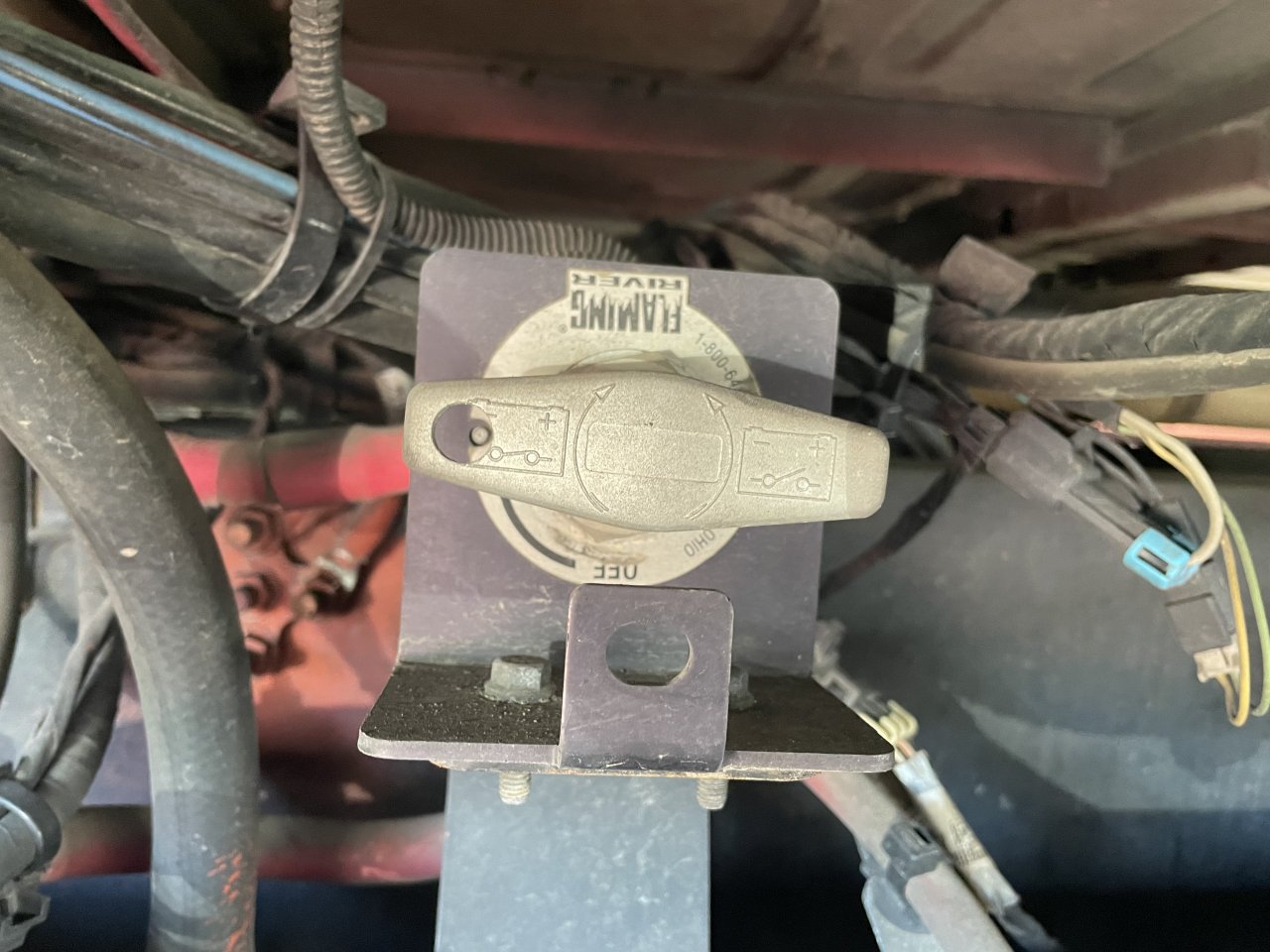

  8. SmallPackage
    5,700
    18,209
    Dec 20, 2019
    Marion Texas
    I use those blade style disconnects on all my classic cars that have one battery. They work fine. Never had a problem in 30 years of them corroding, burning, or melting. Alternator amps back through them isn’t high enough to hurt them and a 900 amp start doesn’t hurt them either.
    For a big truck with Multiple batteries and big amp alternators and capability of 3000 amp quick starts use what @AModelCat cat posted. Those classic style heavy equipment disconnects won’t do you wrong. I’ve got them on all my trucks.
    Reasons to use disconnects is to save batteries from parasitic draw, stop fire hazards if a rodent chews a wire while parked for awhile and is anti theft if hidden.

    Go to a Volvo dealer, tell them the last six of your vin is 944516. Tell the parts guy you need the battery disconnect switch. Guaranteed to handle the amps.

    This is the same switch Volvo installs on their trucks from the factory, but price wise it’s less expensive from Flaming River.
    Siinman, Alexp2686 and lilillill Thank this.

    Yep, just got out and looked...
