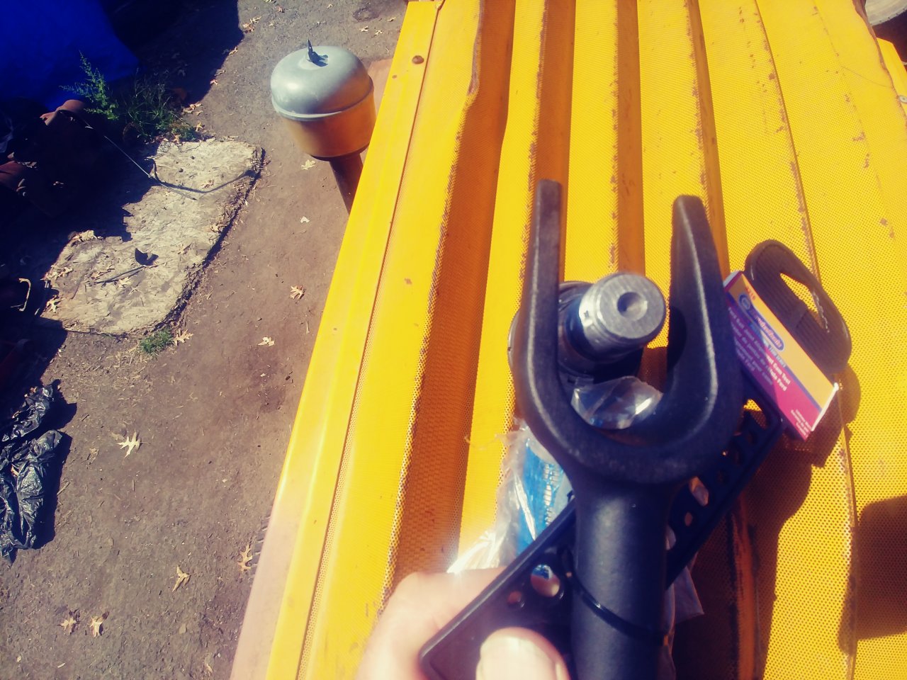

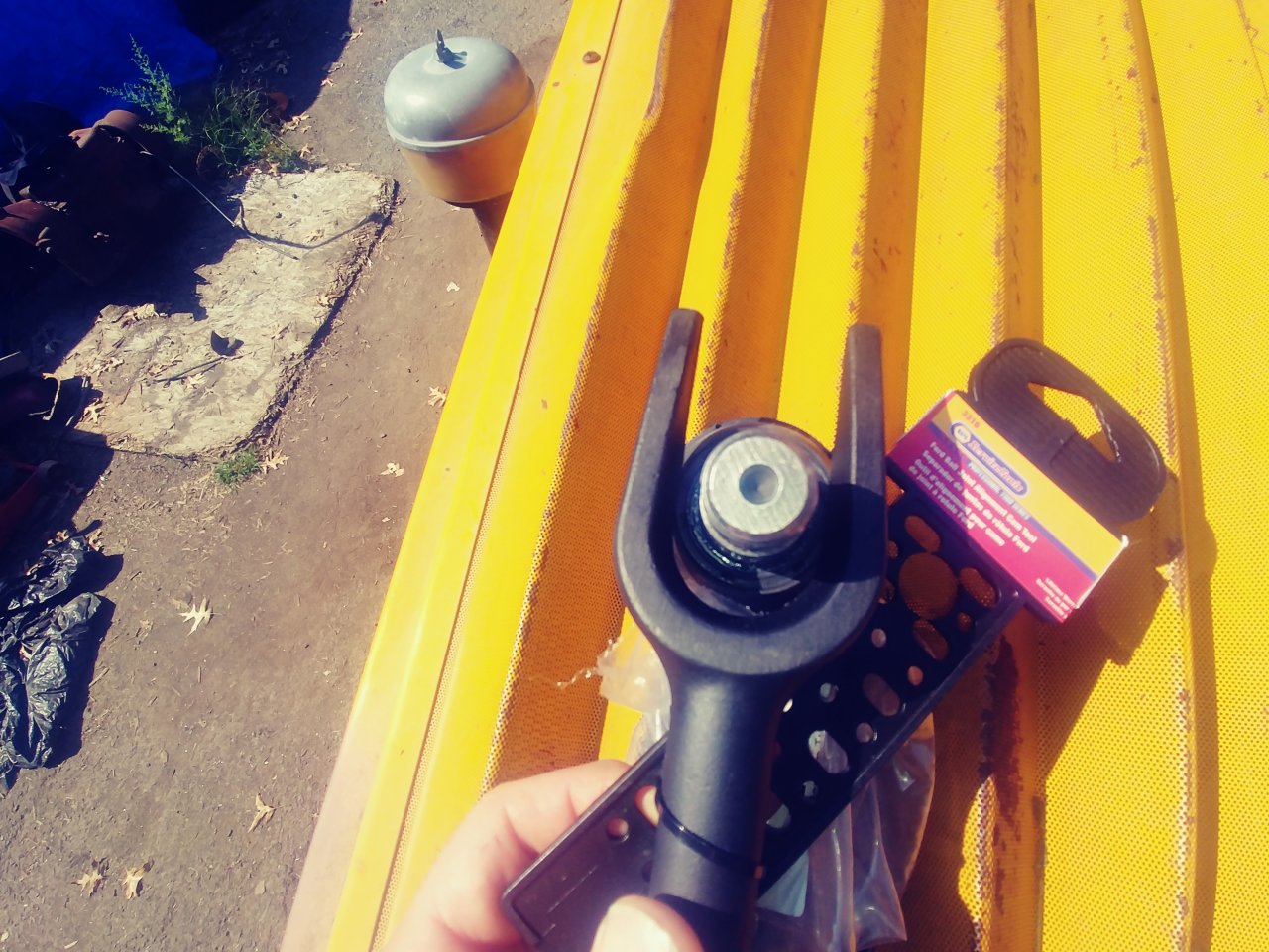

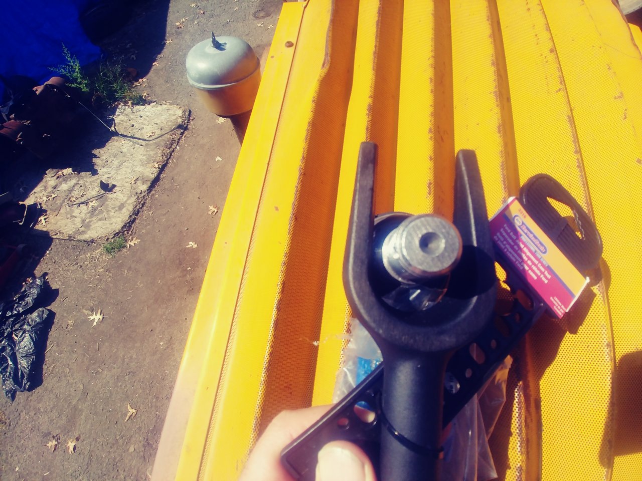

Will this tool work for tie rod ends?

    Yea the tool you have is made for seperating the knuckles... Its called a "pickle fork".
    Place tines between knuckle and ball joint, then hit the end with a big hammer... Might take a few good hard smacks.

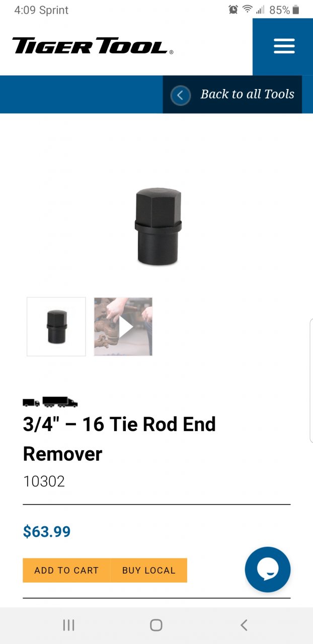

    This removes them without damage to reuse. A steel bearing on the inside hits on the center of the stud with no damage to threads, boot or taper.
