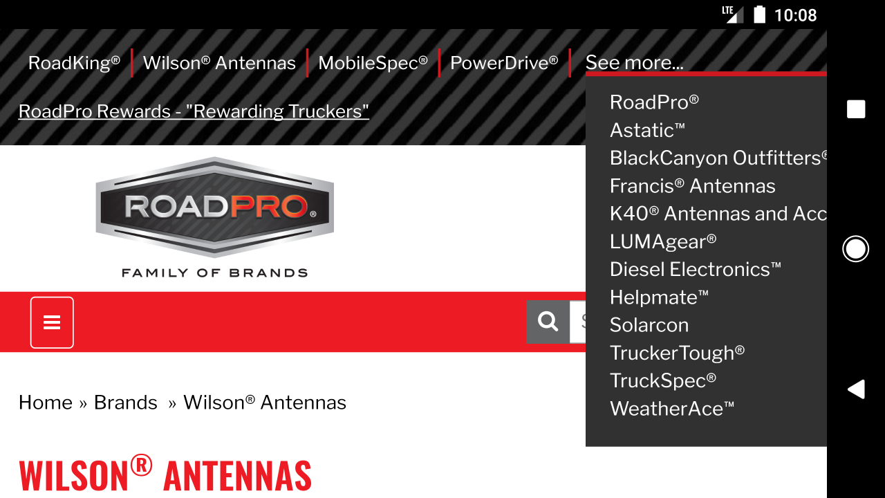

  8. skellr
    skellr Road Train Member
    8,735
    12,187
    Jul 17, 2011
    The Village, Portmeirion
    I didn't know all these are RoadPro "Family". Sad.
  9. wolverine11
    wolverine11 Road Train Member
    1,628
    1,234
    Apr 1, 2015
    Welcome to Corporate America where the bigger fish eat the smaller fish.
