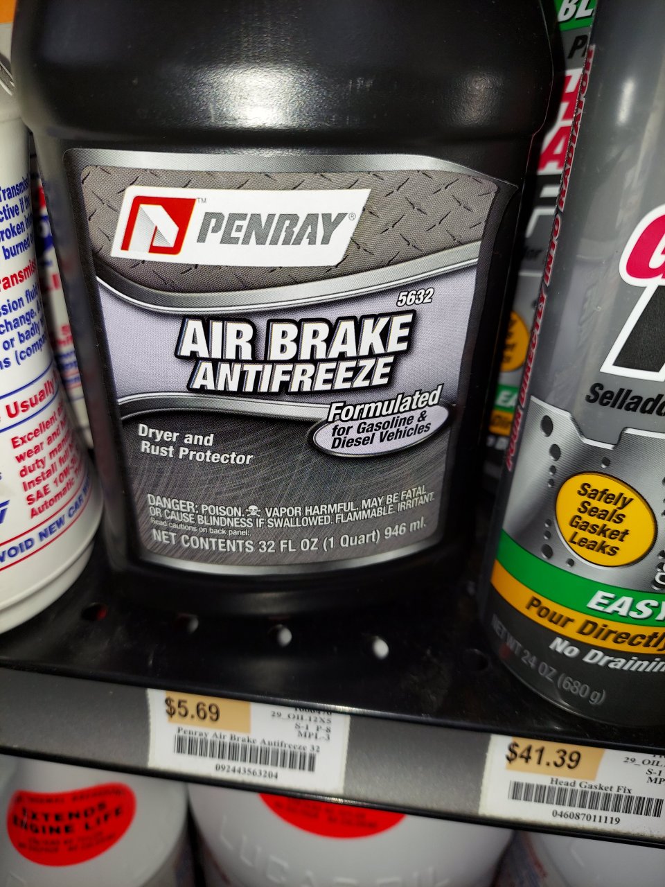

    That doesn't help frozen brakes. It helps to keep your air system from freezing. Frozen brakes are because they have been set and freeze to the drums. Propane torch & a hammer will release them when they are charged. Don't set your trailer brakes in cold weather. Problem solved.

    Formulated for gasoline and diesel vehicles. I had no idea the air system cared which fuel is used to power the engine :rolleyes:

    Plain ol alcohol works. I see there is a limit on how much you can buy at the drug store.

    Thanks, how much do you usually use.?

    Not sure I want to carry a propane torch around. Not setting trailer brakes is already something I do, but that is of little use if you are hooking to a trailer that has been sitting in a sub zero drop lot for days.

    When I drove truck in the Winter I'd carry 1 in the cargo box. No big deal. It made life alot easier. I hear ya on the trailer yard. Just don't put it under the drivers seat. Lol You be surprised how many guys put Compressed cans under their seat. Big no no.

    No issues with tunnels or border crossings?

    People claim it eats the seals in air valves over time. Maybe better to drain the air tanks frequently and make sure the dryer is working?
