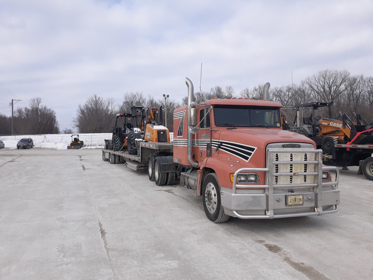

    Hello! The cold weather will be upon us soon. I wanted to ask the experienced hands on here whether or not they run a winter front. I have never ran one on my Freightliner Cascadia or my Columbia before it. I have noticed pictures of K100’s with them on, though. Like I mentioned in an earlier post, all indications point to them being rather cold blooded. I don’t think I’ve ever seen mine go over 200 degrees, even pulling my conestoga. So, do you guys run winter fronts? Do you run one on your cabover? How do I know if I need one? For reference my Kenworth is a 2000 K100 with an N14 Cummins. I do run the Midwest and New England in winter time. Thanks for chiming in.
