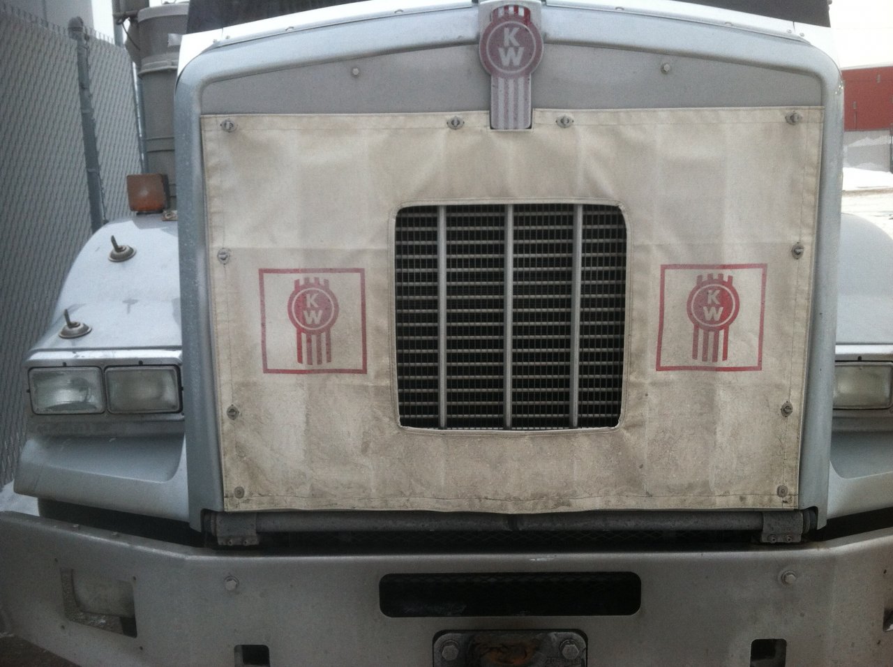

    My last DD15 generally liked it off, but when it got below about -23 you could hear it was running cold. Made more noise. I would put it on below that temperature and it ran better. But the new winter front I can not completely close off. The CAC still needs some airflow.

    Don't they say with these new engines to leave them off?
    I've never ran one. Probably should have with my old Detroit freightliner. I managed to get by just fine without.

    Makes me feel a lot warmer and the truck tends to run better at 175 than it does at 125. A light load on flat ground in 15 degree weather and i might as well shut the heater off cause the coolant just won't get warm enough.

    Then you probably need to replace the thermostats

    Was my first thought, and my second and third. After changing them multiple times thinking i got bad sets, i tested them on the stove before installing them. Final conclusion, a 12.7 combined with the 4 core radiator required to keep it from over hearing on long hard pulls in summer, makes it run cold in winter. Block off some of that grille with a winter front and it runs a little warmer, but forget about counting on the engine for heat while idling. Even bumping it up to 1100 rpm and it barely breaks 125 degrees.
