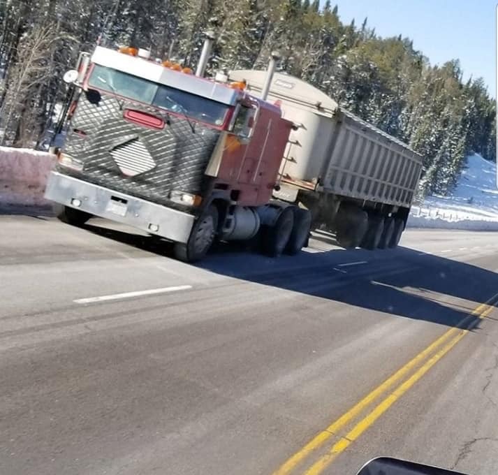

    Mine came from factory with the turnbuckles installed and winter front and bug screen.......

    A full Canadian winter front.......:)
