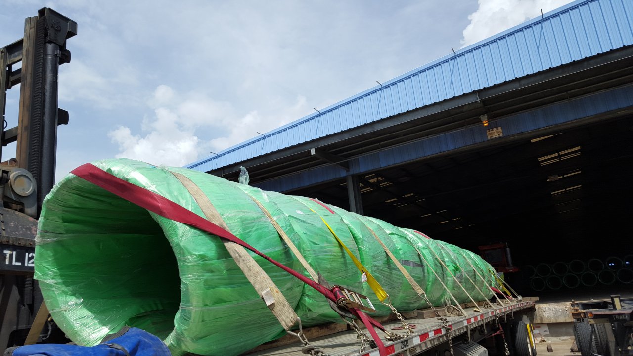

  8. Mr biggs
    Mr biggs Light Load Member
    80
    107
    Aug 18, 2016
    right near the beach
    20170418_144045.jpg yeah that's how I did it

  9. special-k
    special-k Road Train Member
    1,515
    3,239
    Dec 27, 2008
    Southern Ontario Canada
    The other thing we used to do was take a 5ft 4x4 and stick inside the front coil on a 45 degree angle or so. The bootom would dig into the wire and the top would hang out above the coil a foot or so right where your strap is. Then we would chain it back on both sides so it pullsd against the top of the coil. That have you a little piece of mind about the whole thing leaning forward as you went down the road. Some guys would put a trip block chained forward on the back on the floor to keep the bottom from sliding out. That was with bare coiled wire not plastic wrapped. I usually would put my rubber belting under the straps and run them on a bit of an angle so the straps couldn't get wedged in the wire. Lots of fun on a 90 degree day in some dirty old mill lol sure glad i dont haul coiled wire anymore. We would whine for a week when we had one of those loads.

  10. reverendhandy
    reverendhandy Medium Load Member
    309
    401
    Jan 24, 2017
    Modesto, CA
    Looks good, but I think I would also have used 4- 2" ratchet straps and formed an X across the front and the back of the tube.
    Never really did just trust one strap across the back.
