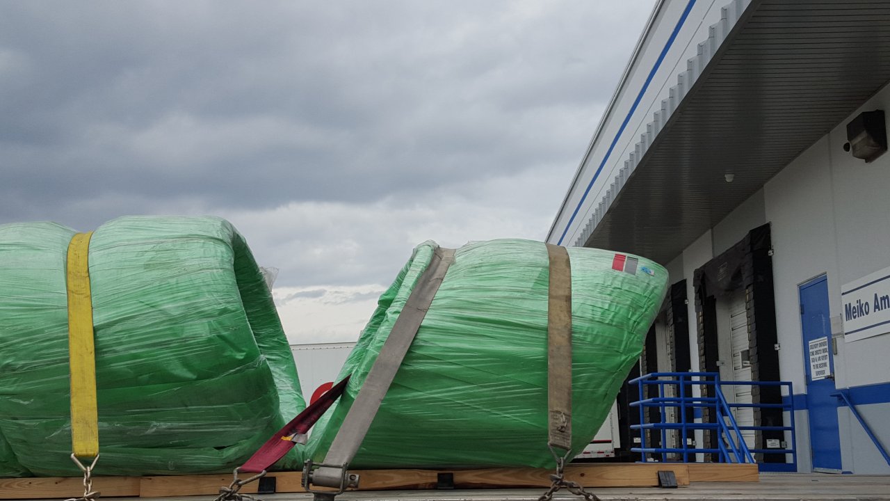

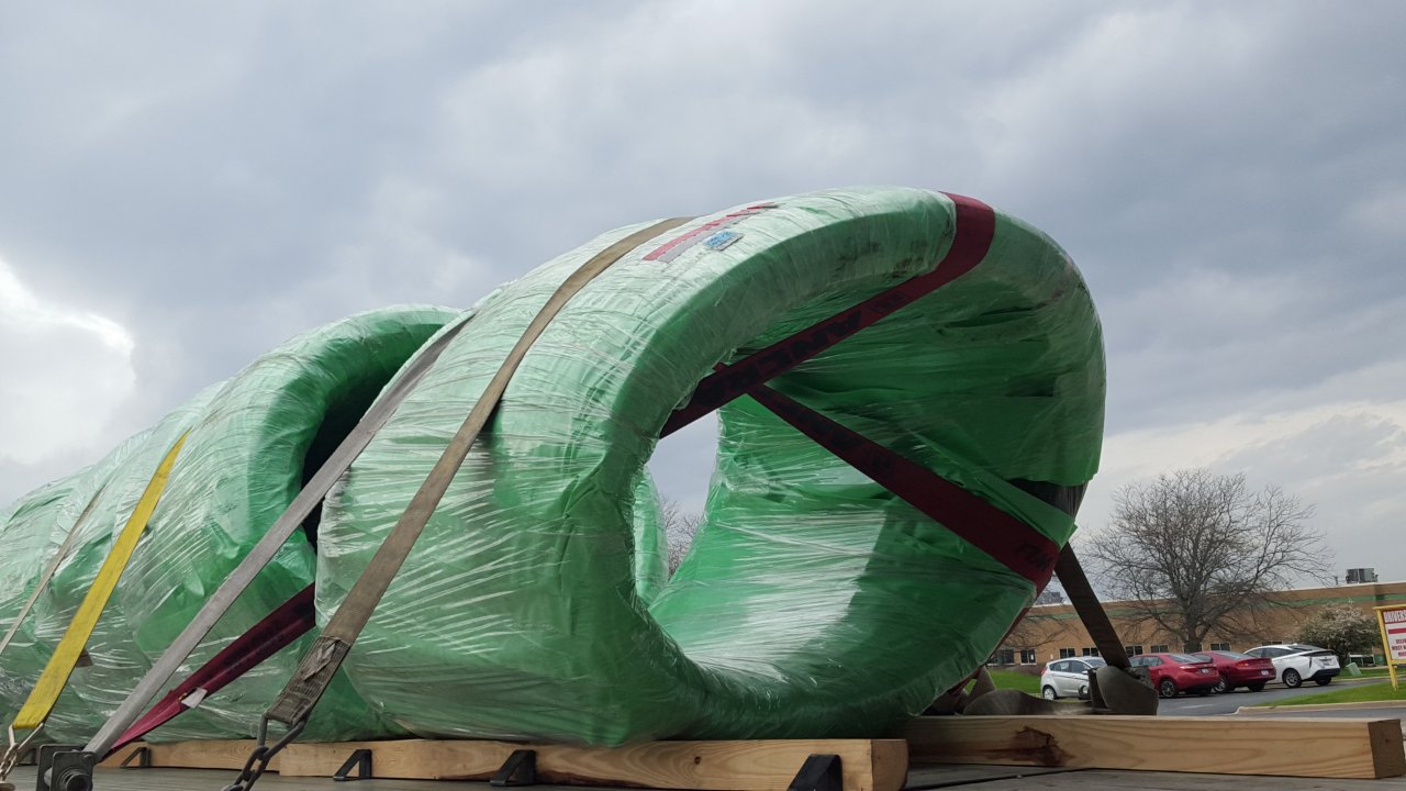

    20170420_094027.jpg 20170420_094008.jpg that last coil was a bugger, I'll do it a bit different next time. Appreciate the tips and tricks definitely useful info.

    Oh that's nasty. Was that the way the coil was or did it shift?

    It shifted, the red strap did its job but just did it alittle later than I'd like. A couple lessons learned on this load.
