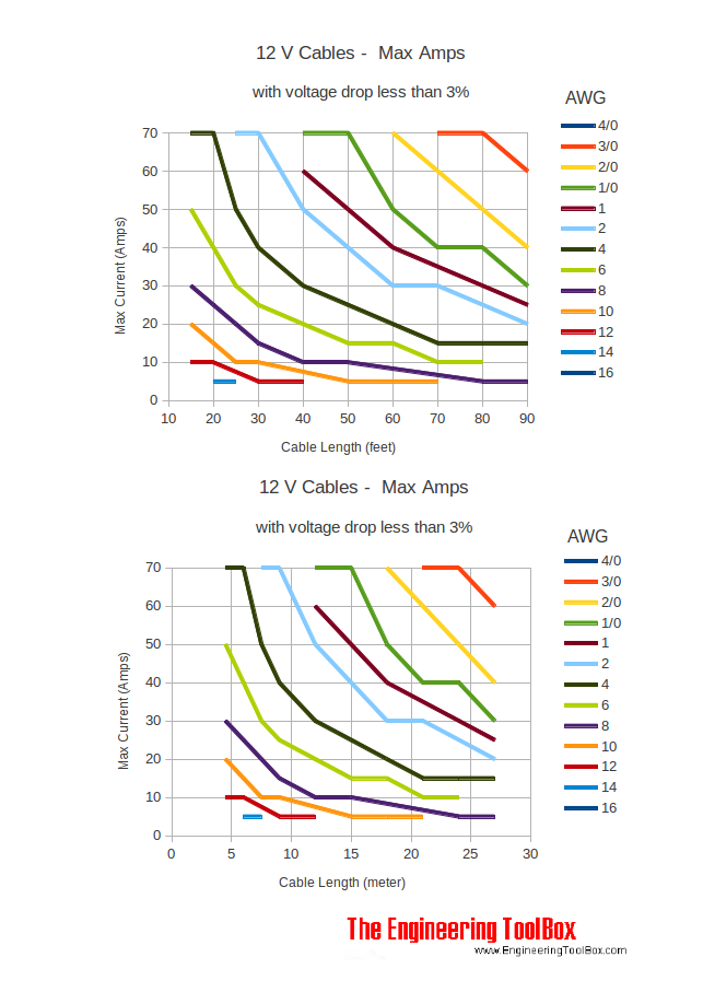

    See if anyone could help me out. I have a company truck a peterbilt 2014 it has the battery's under the passenger seat. I just can't figure out how to run 4 gauge wires from battery under passenger seat to the texas star dx 500. I been trying to figure out how to run the wires but I can't find a way. I might have to drill a hole through the battery box unless someone who has been through this process could help me out. The amp is going to be very close to the battery on the floor so I don't need long wire 3 or 4 ft. The most but need help. ..Thank you. ...................... do I need to drill hole, or is there a way to run the wires. Someone please rescue me.
  11. rabbiporkchop
    9,678
    6,548
    Feb 9, 2012
    Wapwallopen, Pa
    Good guide to follow.
