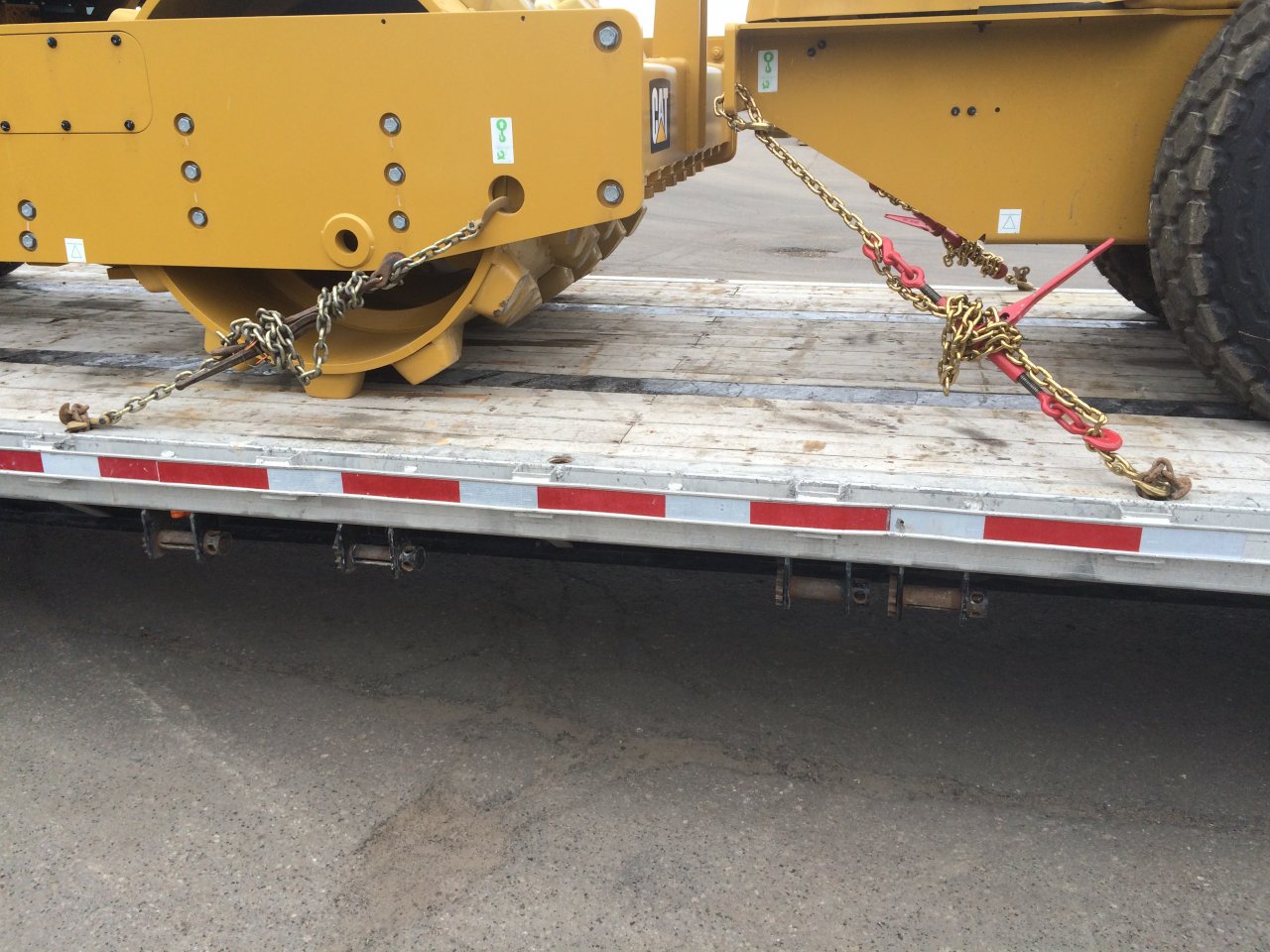

    Chain binders- there is a huge difference in quality between off-shore and USA. Company supplied new Chinese ratchet binders are junk, the threads bind unscrewing them screwing them even with lube. I've snapped heads off snap binders before. I've heard of other guys breaking binders too, or the hook end on a chain breaking.
    Chain and binder on the left is USA. On the right is China. It just looks and feels cheaper, to me.

    Couple Cat rollers?
    cke and DDlighttruck Thank this.

    Yes. Nice and easy load.
    Sure.... G70 chain is G70 chain.....just read that last night actually.
    And funny how the snap binder I posted is an old Lebus binder, yet I've broken new Chinese binders, and others have done the same with chain and hook ends.
    I threw in the binders as personal experience adding to my opinion that Chinese stuff is in fact cheaper quality. Sorry I will try to only comment on what the OP posts from now on.

    Hey DD, I think if you put 4x4 on the deck lengthwise you can drive the rollers on them and keep them off the deck. They fit between the feet. We did that on a few military rollers like those.
