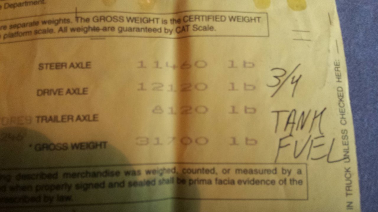

    so you'd want 22 feet front half and 26 feet back half on a 48. i've always just gone with the turn signal or marker light which is the half way mark. 24 front and 24 rear. loads are usually close enough to not worry about it. at the most it's been 1000 more on the trailer. but when you load with a lot of NON english speaking. they only understand the hand pointing at the light.

    some like to run with steers at that 1,400 weight in the picture to save on wear and tear on the steers. but your shorting yourself 1000 pounds on the drives. no big deal for those of us running spread axles. but can be a big deal for closed tandems.(think, 68,000 lbs. total weight between drives and trailer axles.
    some of us are running 12,400 on steers with full tanks. if the truck is rated you can go up to 13,000. i've actually had to use the excess allowed weight twice on my new truck. as the drives were too heavy.
