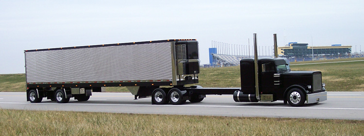

    Blair runs over size/over dimension freight. His truck is also a "super sleeper" type. Significantly longer than the "standard" sleeper trucks out there.
    New Trucks
    Which would be something to keep in mind for your lease contract stipulations. No combinations of truck and trail over a certain overall length in the standard tractor trailer parking spots. Also stipulate that nothing can be hanging off the back of the trailer. Was a thing to stretch the wheelbase of the tractor so that 60 foot lengths of rebar/steel could be hauled on a 48 foot trailer by over hanging front and back of the trailer by 6 feet each. Lead to this fashion subculture in trucking.
