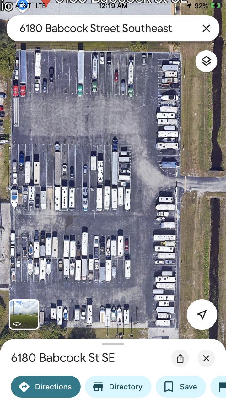

    First, I got no idea what you could charge in that area or if there’s even any demand.
    Here is a screenshot of where I park in n Florida..Was on a waiting list for about six months to finally get a spot..Got the call for the spot exactly 3 days after my truck and trailer were stolen, lol.
    You can probably use a scale ruler to get a decent idea of the layout. I pay around $320 per month. Been there about 3 years now and for my convenience I just left a cred card on file so I’m not bothered every month.
    Has gated entry, security cameras and it’s paved.
    Those are the three must haves for me.
    Gravel lots..don’t want to have my tires packed with stones.
    Dirt lots..ain’t dealing with dust covering my truck every time the wind blows or mud every time it rains.
    If your area supports it go all in and make it nice to attract a decent clientele. Where I park Walpole has about a dozen or so of the spots on a long term basis. These trucks are brand new with brand new bulk trailer’s.
    Sometimes going the cheap route will end up biting you. Cheap will attract broke ### owner operators that you’ll be constantly chasing for payments or turned into a dump with abandoned equipment.
    Florida has easy peasy eviction laws so you may want to look into that issue also.
    Good luck
