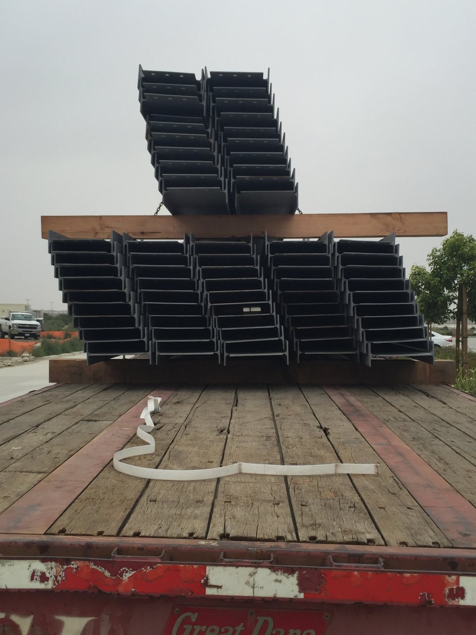

    7EB71D98-62AD-4E4E-A0A2-6248CE3028DF.jpeg BBF92094-EE1D-4A87-B56B-4E347071AD37.jpeg No X chains on these loads.

    Long as you know what your hauling and know how to secure it..... it’s a walk in the park.
