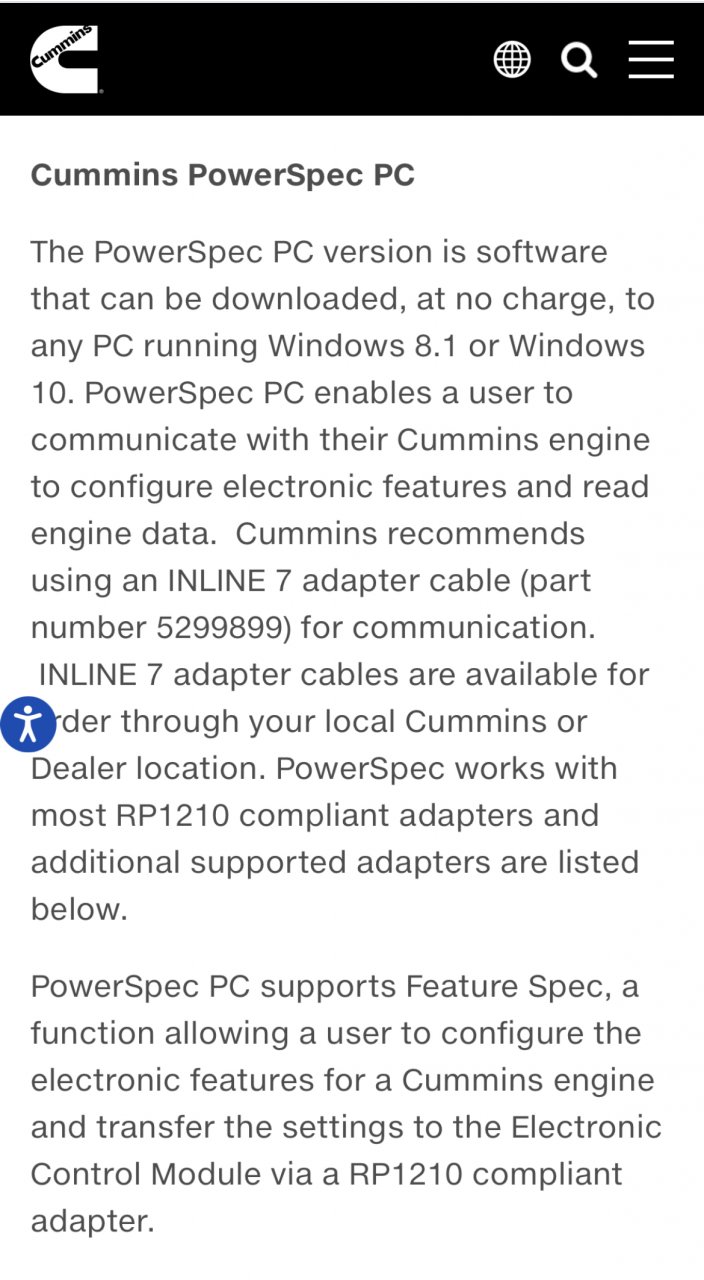

    You can download a software program for PC called Cummins PowerSpec for free from Cummins but the expensive part is the cable set/adapter you need to hook laptop computer up to your truck. You can find these cables, called INSITE 7 RP1210 Compliant Adapter, for sale on the internet from $800-$1200 depending on if you can find a good sale or not. I wouldn’t buy from a Cummins dealer though or you’ll go bankrupt! Also stay away from the generic $200 knock-offs as these won’t work due to outdated software permission settings. Here’s a screenshot from Cummins website:
    xsetra and Dave_in_AZ Thank this.

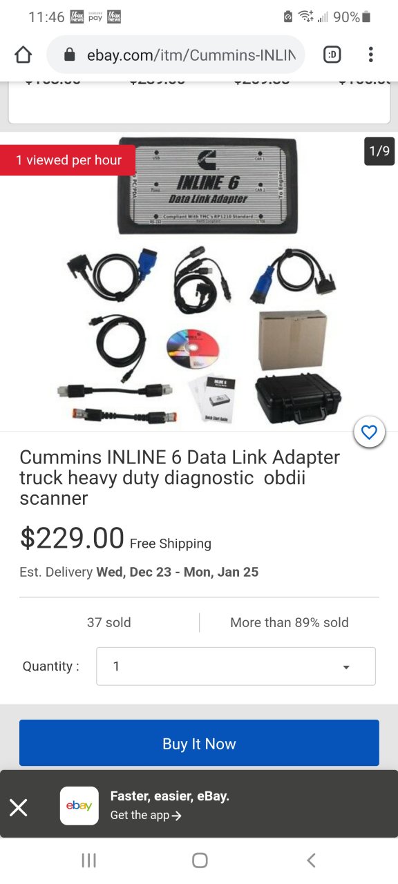

    Or get this
    Dave_in_AZ Thanks this.

    I heard you can’t get access to all the parameters from those generics. If those worked at all you’d be extremely lucky especially with new trucks
