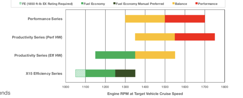

    It’s depends on what you use your truck fir and what rpm you going to drive in your high gear.
    I HAVE ATTACHED A PICTURE
    Performance series you can expect to get a fuel economy from that motor itbuild to pull heavy haul higher RPM above 1350 on your high gear doesn’t make a sense you driving lower RPM and try to save fuel. it’s going to take same
    (Economy )series its build to have a economy as picture show drive on lower RPM you can take out a fuel as much as you want depends on your drive.
    (Productivity series) it comes with 2 hardware efficiency and performance up to you to choose if you choose economy series you can change through ECM power terrain on truck what you want economy or power but you have to be careful about the RPM if they go higher 1350 non of the motor you can have fuel economy. All of them will be balanced power.

    Thanks for the explanation. I had never heard of the productivity series before.
