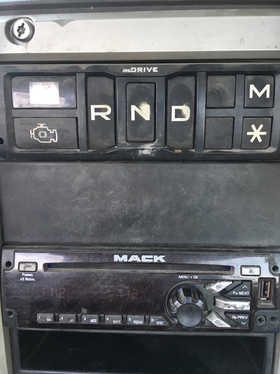

    There is a M button there. That's manual mode.
    I don't dare sprout the rest of it. You have to go into bobtail, pick manual mode and play with her until she rides the way you like it at your will in the gear you want.

    Give me 10 minutes bobtail in a 3 acre lot, then we all will know eh?
    Sometimes that is exactly what we did at the auction house with the then newer generation of autos Idrives etc.
    Im not too proud to admit I don't know. But I do want that thing for a few minutes in private out back to learn it though. To see its worth a ####.

    If it’s an Ishift you can hold the + button to prevent a down shift or the - button to prevent an upshift. Putting it in manual will work too. On the rear of the box, on top, of it’s the premium shifter, you’ll see an e/p button. That is the eco and power settings. I’d leave it in eco most of the time unless you need to cross 4 lanes of traffic real quick.
    The box also has an L button on the lower rear for limp home in case there is some sort of transmission failure.
