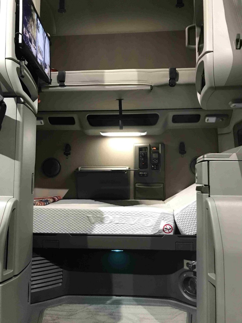

    I am thinking of getting this thing without their batteries and just run it of my 4 truck batteries with inverter. Has anybody tried that?
    Don't expect much from it, but hoping it will maintain decent below 70f temperature in the sleeper with closed up curtains during 11pm-7am timeframe.
    Not sure if truck batteries will be enough for 8hrs running time, since I also have a small household refrigerator

    I hate the idea of having a generator and hassle that it brings. My plan is to install a curtain on the bottom of the top bed, so it creates a small isolated space in the bottom bunk
    Since the space is gonna be very small, I think this unit will be able to cool it off enough for comfortable sleeping.
