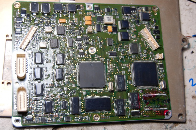

    Ok, some new information.
    I have wrote about error 32 before. Today we have mounted gear box, and now I see it is in fact error 132.
    It change things a little.
    For error 132 manual says:
    It seems like there is a problem with one or more gear shift and/or shift sensors.
    First step now is to dismount and clean all of shift cylinders and to do a visual check.
    Any experience with similar problem?

    Yes. Condition of the gear box is as it was before. We must preheat it and it switch to neutral. After that we can drive the truck.
    Now I am thinking what is connection between heat and gear shift cylinders and/or sensors???
    Why it works only if we preheat top cover of gear shift module and if gear box is hot?

    I use to find problem this way:I put TCU on table, power it with 24 V (on US trucks ZF uses 24 V units too), connect J1939 ore K-line to diagnotstic tool and heat board in different places with soldering air heater ore with IR heater.
