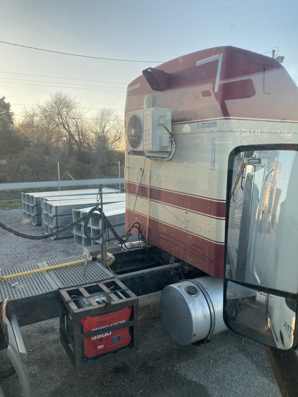

    This guy had a good setup, heat or cool unit.

    Looks good, but the gas generator has to be an inconvenience. Constantly going outside to start or stop. And how well will that residential setup survive the dirt and vibration. I just don't see enough of these to instill any confidence.

    That is a good looking unit. What did you pay for that?
