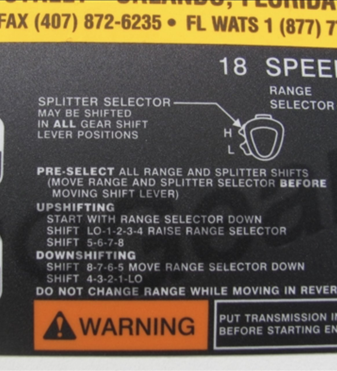

    I've been told or read that you don't preselect a split on an RTLO for this very reason.

    I have been told that we are not supposed to do that with the RTO, but RTLO is good for preselect. I might have been misinformed but the strange thing is that it happens just sometimes in 5th gear.
    And I agree that if I'm not supposed to preselect when I go from 5H to 6L that might happen, but why does it make a bang when I go from 5L to 5H. I don't know how else to shift that except flicking the switch and releasing the pedal...

    My tranny does same thing and as far I understand me and you need to take transmission out and fix that, I'll do that when I'll be changing clutch. What I do is if you in 5L going to 5H first take it out of gear flip splitter to HiGH and put back in 5 gear I shift like for past year this is Only the way to do it smooth, otherwise you going to destroy your tranny. So that's how I shift on each gear that does that. Easy! Try, n let us know!

    Hey bean. All 13 and 18 speeds rtlo have Always required preselect or you risk severe damage.

    You are right, that is other way to do it without getting the bang but I don't think they designed it to shift that way...

    That’s the only way to drive the truck unless you want to break it. I own a 18 speed pete
