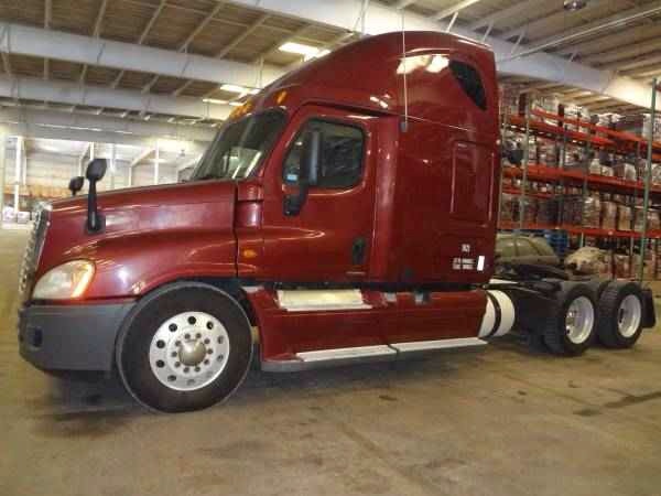

    I found two 2009 freightliner Cascadia's both with 750k miles
    They are automatics the guy said 60k takes both. I had a shop check one out he found about 6,000 in issues that includes rear tires and they have Detroit 60 in both. Shop tells me to stay away from them. Should I just go purchase an older truck without egr and dep. I don't drive but want my driver in s comfortable solid truck
