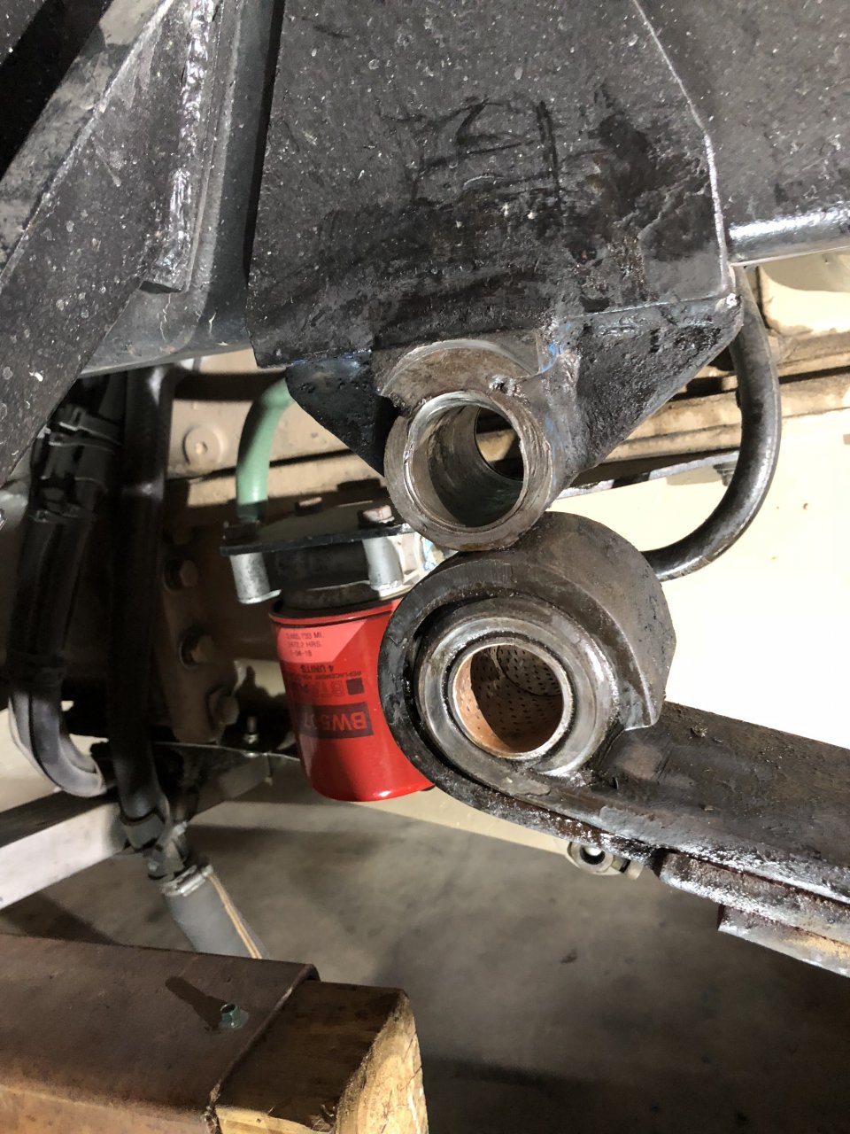

    I just replaced the ones in my ‘67 last month 902BFB30-9CD9-4ABC-B767-E8AFF6BC78E9.jpeg
    Top pin
    You can see the bushing in the spring is still good. Hanger pin and bushing took the beating. These however have been in this truck since Feb. of 1982.
    AModelCat and LameMule Thank this.

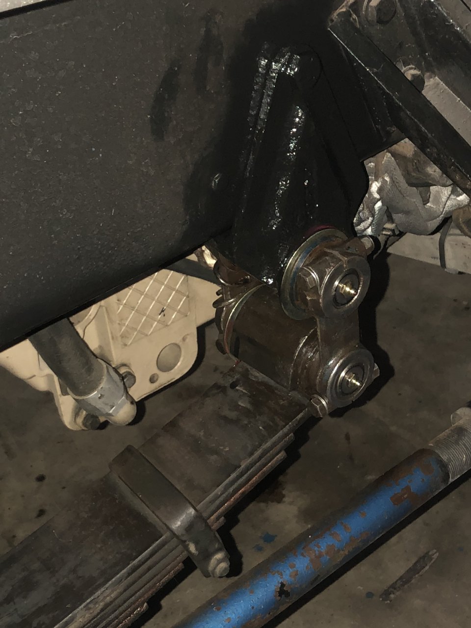

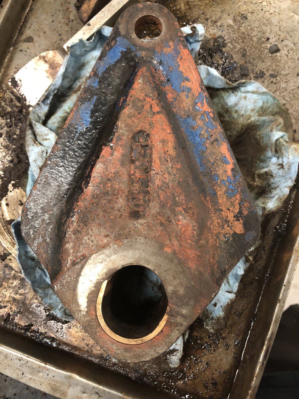

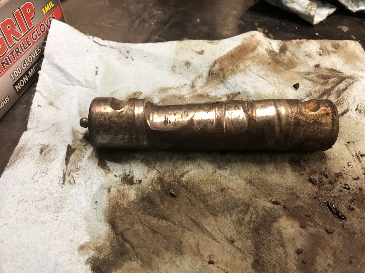

  8. SmallPackage
    5,818
    18,640
    Dec 20, 2019
    Marion Texas
    Rh done.
    Lh hanger bushing
    Lh done
    spsauerland, AModelCat and mitmaks Thank this.
