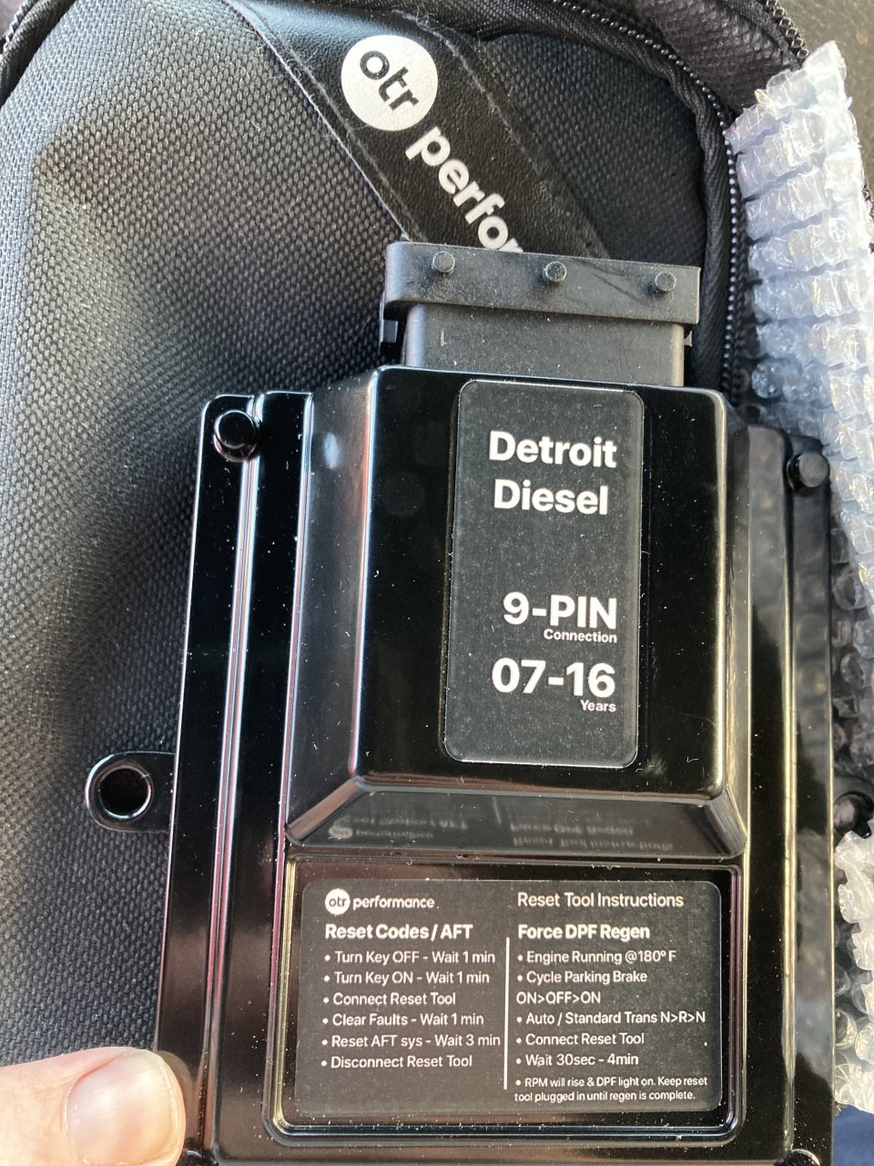

    Tip.
    Get one of these from Otr performance, clears codes from obnoxious def junk.
    Unless there really is a problem it won’t reappear most of the time.

  10. Judge
    13,943
    92,776
    I ordered mine from amazon,
    Had a check engine light come on earlier with no codes, cleared it in less than a minute after hookup.
    Specify whatever year model range.
    I keep mine in the truck
    OTR Reset Tool | Detroit Diesel
    Gtrucking Thanks this.
