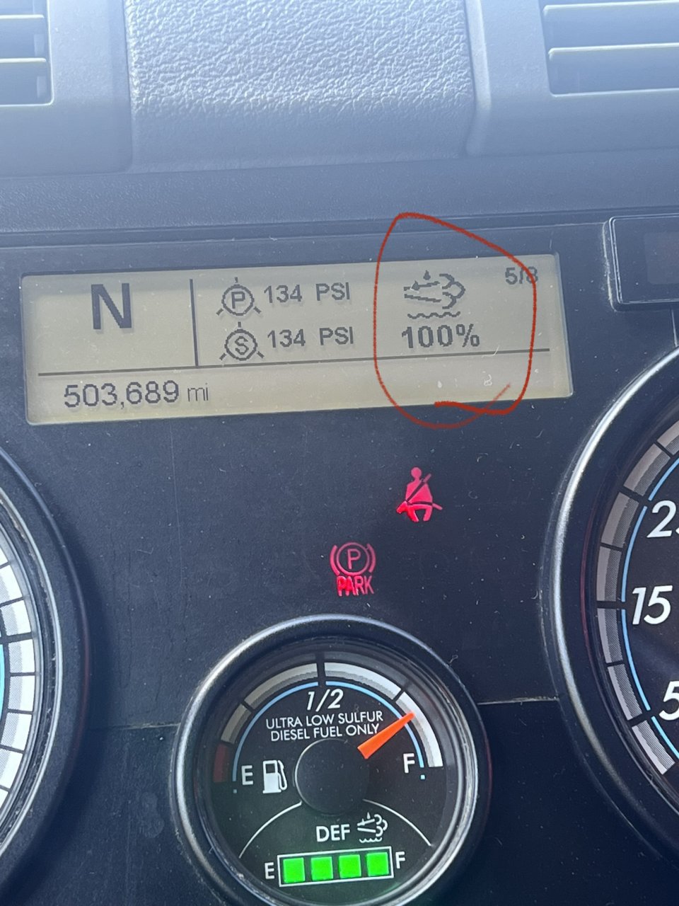

    After a parked regen my spot level is still 100%
    I don’t have any cel or codes also haven’t had derate issues
    Is it possible soot level needs time to reset or is malfunctioning?

    100% doesn’t mean it’s full.
    The engine controller reports the DPF soot load as a value from 0% to 250% not 0% to 100% as you may expect. The value may fluctuate, and this is normal
