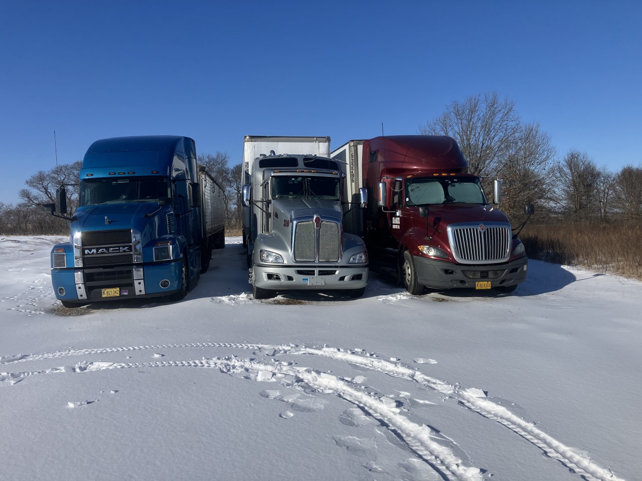

    Mack’s are good. I have a 19 anthem. But they’re a little heavy.
    I’m about 1000 heavier than the kw and almost 2,000 heavier than the international with the same trailer.
    they ride good. Drive good. Turning radius is great even compared to the t660, it’ll turn in places the kw can dream.
    double bunk, with apu and flow below on this one.
    Mine just turned 740k miles when I parked it Friday.
    Still quiet ride inside, this one you gotta shut door hard on driver side or air comes around it.
