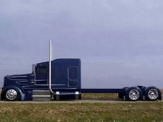

  5. AModelCat
    29,756
    165,310
    Dye Guardian, Ooops, 207nomad and 3 others Thank this.
