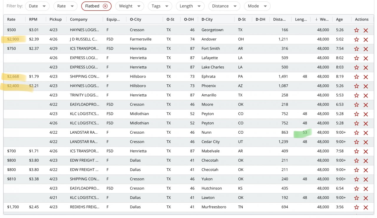

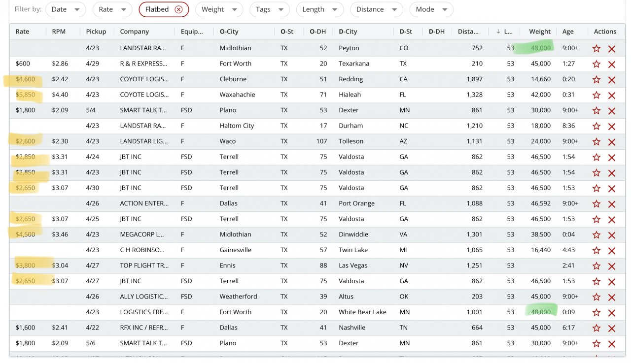

    You will probably get some varied answers on this. However here is what I’ve found.
    I’ve got a 53’, never been turned down for a load because of having a 53’ but I have gotten some loads because of the 53’ often when the broker did not even put that in the listing.
    Conversation goes something like this... blah blah blah.... blah blah blah.... what size trailer do you have again? 53’? great that’s what we need on this one...
    I then work on a bit more cash for it once I find that out.
    My setup is fairly heavy with all the gear onboard so I am weight restricted so there is that. I typically search for the lightest stuff I can haul anyhow. But with all my gear and truck I don’t do 48k. I really analyzed this and with the help of @blairandgretchen (talked me off the ledge on this one, because a guy offered me a pretty sweet 48’ trailer at a nice price) I decided on the 53’ it is a little tougher getting in and out some places but not bad. I typically don’t look at any loads over 46.5k (even though I could go as high as 47k+) like I said the lighter it is the happier I am if they pay is there. I bet if you really looked at MPG and weight even if a lighter load paid slightly less you may see better overall income due to fuel savings.
    If a 53’ is what works in your are and rates are nice then that may be your answer.
    So here is a current screen shot I took off a load board of 53’ loads (only a few of the ones listed and 48k loads again only a screenshot worth. There is definitely a lot more 48k+ loads. However do they really pay better? I really don’t think so.
    The first screen shot will be of 53’ and the second of 48k... I highlighted the offered rates to help you decide. Now on the 53’ loads the JBT loads may be all the same load. Also note on the 53’ screenshot there are only 2 loads I could not carry. Of course as you know the loads are all to be negotiated but there are some starts there. Also of course some guys with nice 48’ aluminum trailers can carry quite a bit more than 48k so if it pays off there maybe. I looked at some higher than 48k and really not much more there. Although can guarantee they are negotiating with broker if it is heavy.

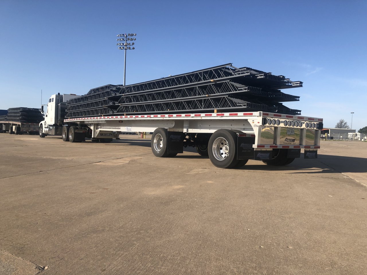

    53’ with a slider, all the way if you can afford it? I started with a 48’ that helped pay for the new one. Never one time could I NOT find work for the 48’. But we have a few customers that really like 53’. 3951981B-234F-4B7F-BA27-956491DA4BAB.jpeg
