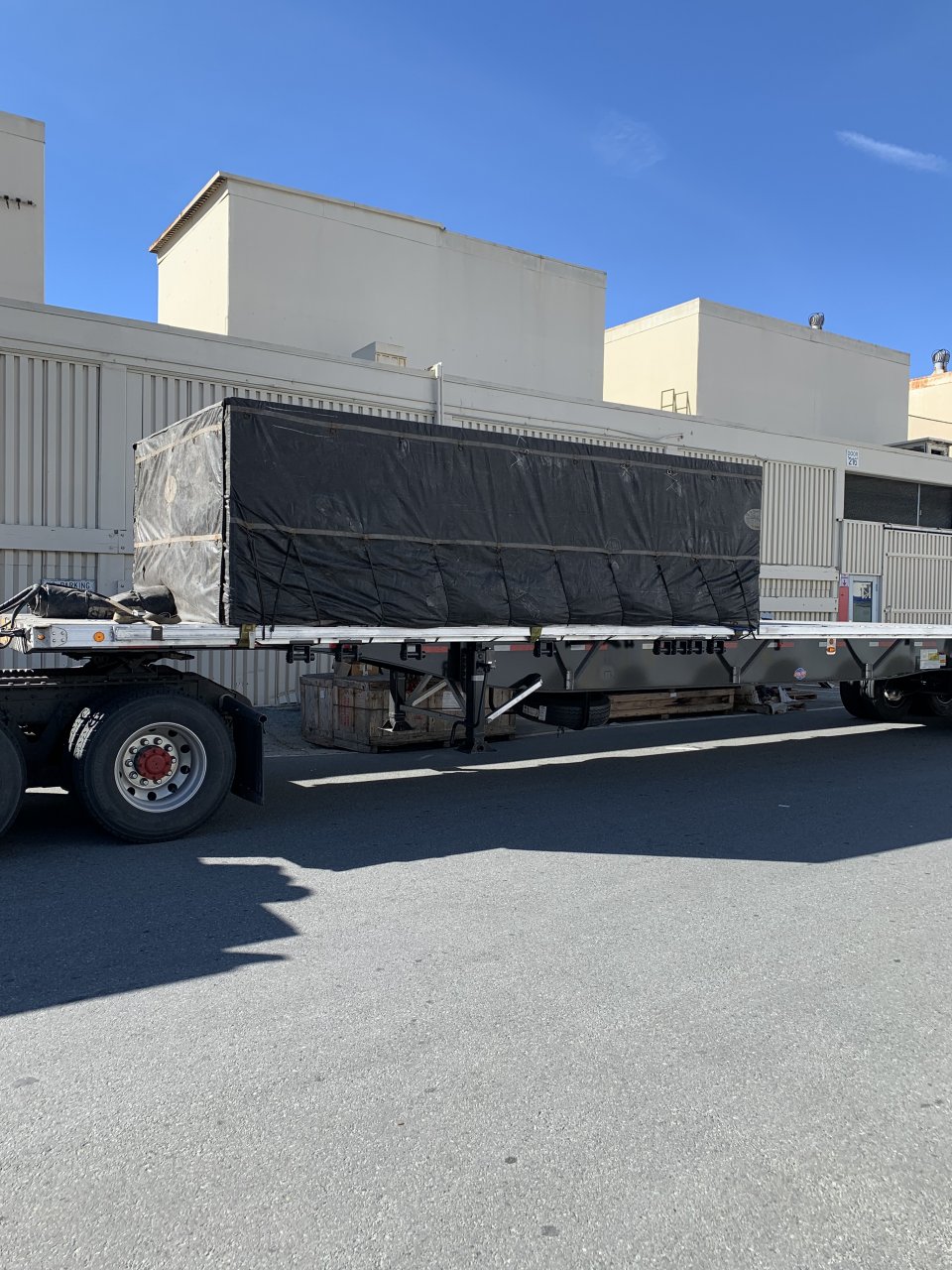

  7. kylefitzy
    kylefitzy Road Train Member
    4,770
    19,886
    Aug 12, 2007
    Kansas city,Mo
    All the way back is where all the cool kids run their fifth wheel. And I mean ALL the way back. 3C0071A4-8761-4508-B47C-B6BEEA2A7E39.jpeg

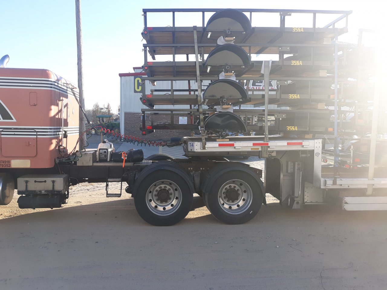

  9. Diesel Dave
    9,931
    34,878
    Jan 20, 2010
    Hesperia, Ca.
    I’ve done it when I haul 60’ tower cranes sections.
