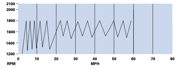

    The hard part about this is there is a question about which 9 speed and which 10 speed as there are numerous versions with different gear ratios, overdrives etc.
    While Eaton annoyingly doesn't have consistency across their charts in their sales brochures, the peaks below are about the same but you have to ignore the troughs.
    One 9-speed
    One 10-speed
    While there is a small amount of difference, except remembering where to shift when you go to high range I don't notice a diffrence.
    Some of the 9 speeds are convertible to 13 speeds, which has more value IMHO but really should have just been bought as a 13 speed in the first place.
    The above 9 speed can be converted to a 13 speed which has the chart below.
    While it may just be the versions I have driven, 15 speeds which typically shift like a 9 speed with a low-low range vs upper splits is the only one with really odd spacing I have had.
    But the non-spliting modern transmissions weather they be 9, 10, 8ll etc... all seem to act the same on the road to me.
    Some 9 speeds have a really high ratio reverse though and that can be problematic based on your use case.
    While opinions differ, if you want absolute fuel economy or drive in the mountains the 13/18 speed transmissions are a huge step up but I don't care enough about the minor differences between the non-splitting transmissions enough to care. A useful cup holder is higher in priority IMHO for highway use compared to 10 vs 9 speed.
