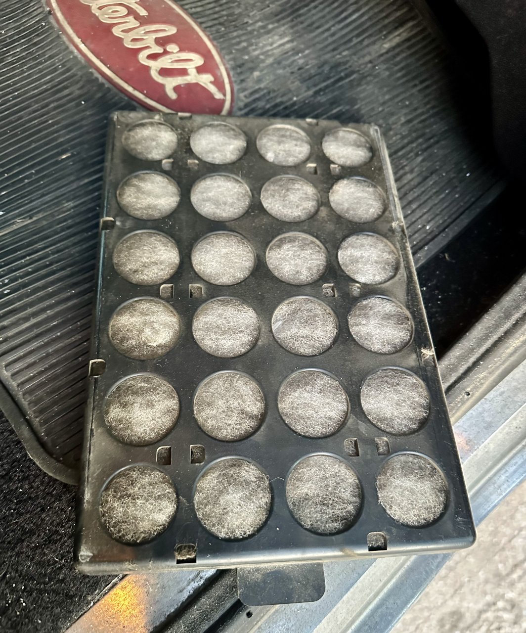

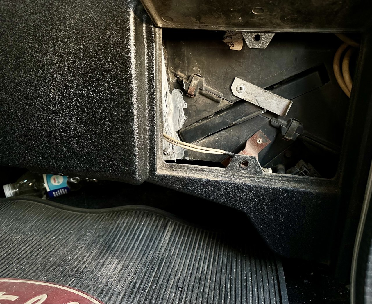

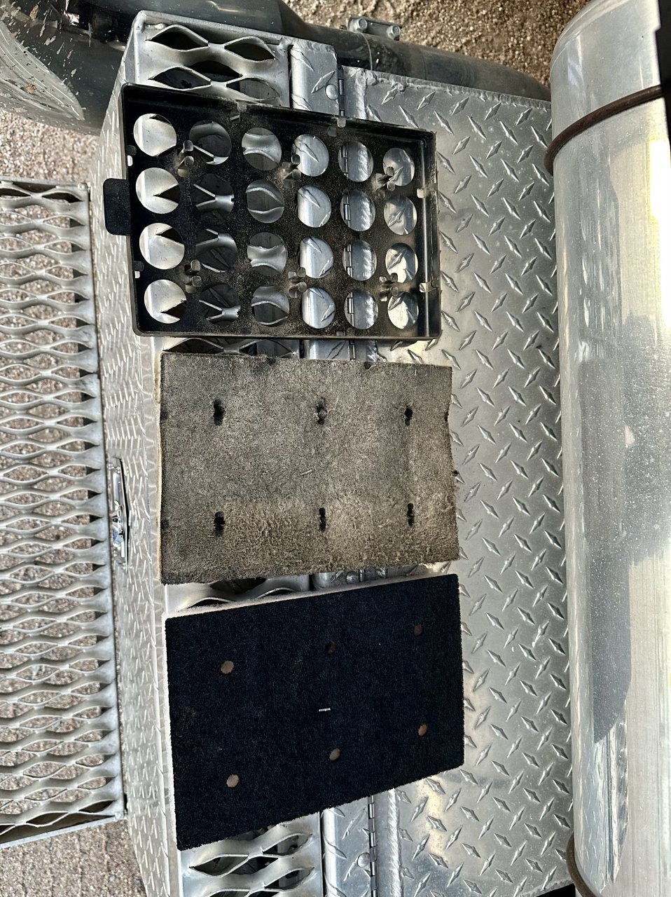

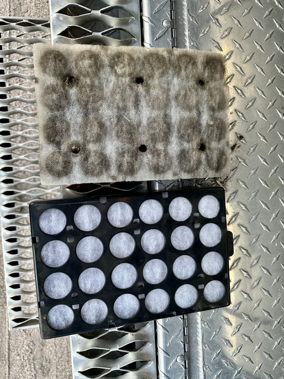

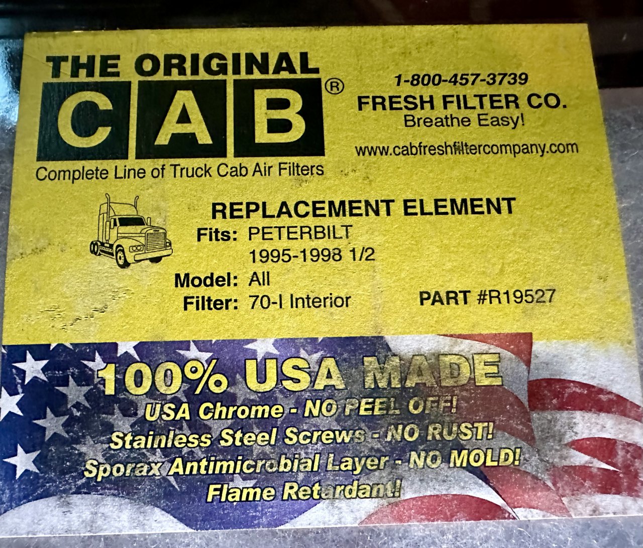

    If you can get up in there (in the first picture) and clear as much crud off that coil - it’ll help. Also coil cleaner for AC units.
    When I replaced mine it was just plum nasty. The connection at the firewall broke which led to a new condenser (evaporator?) .
    Also, shut off valves on coolant to the unit for summer helps.
    I buy those filters 10 at a time and change them out. Must be an ex trucker, it’s the first company I ever dealt with that sent out the product with an invoice for payment. Like - no credit card. Just send it and trust you pay.
    Hope this helps.
    IMG_8729.jpeg IMG_8730.jpeg IMG_8731.jpeg IMG_8732.jpeg IMG_8733.jpeg IMG_8734.jpeg IMG_8735.jpeg
