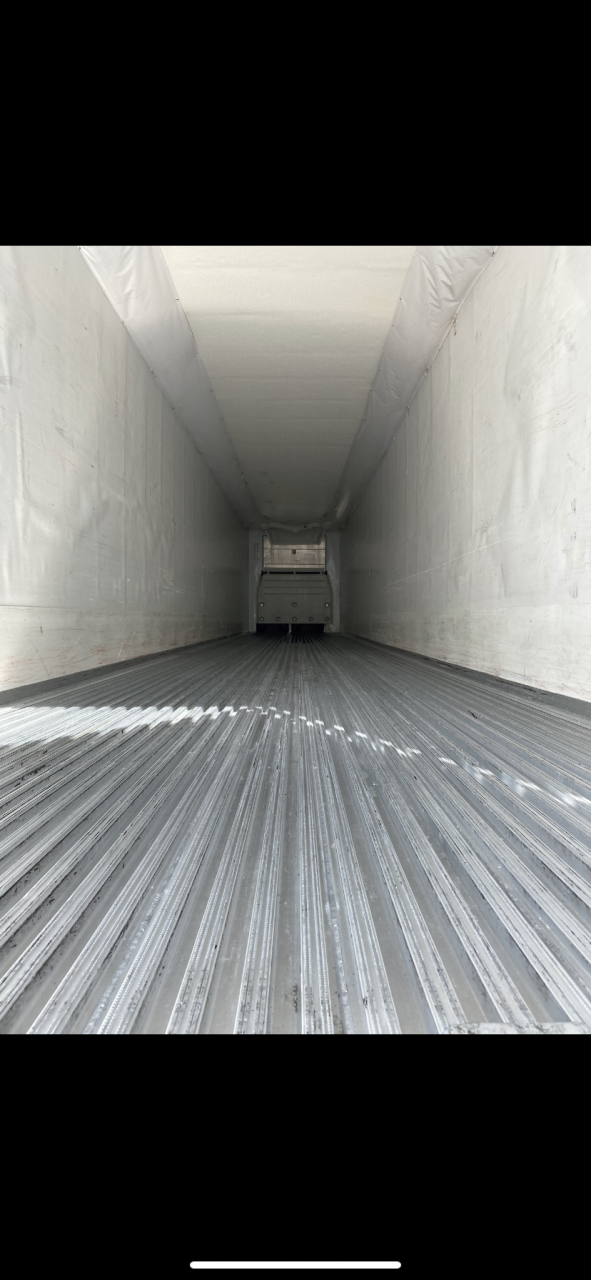

    What’s up guys. My apologies if this topic has been previously covered but I couldn’t find it . I purchased a 2013 wabash reefer trailer. Is it possible to add e tracks to it ? 9A6D1529-6312-4C0B-9B6D-2730A0A74A17.png

    Anything is posible with enough time and money.

    Any good trailer shop should be able to do it. I suggest running 2 rows, one low and one high.

    That's nice looking for a 2013. Figure around 750-900 for a row installed full length both sides, nearly twice that if you want them recessed into the wall. Make sure it's done by a decent shop with reefer experience, because if it's poorly done then they can leave openings for moisture to intrude on the insulation, which will add weight and reduce cooling capacity over time.
