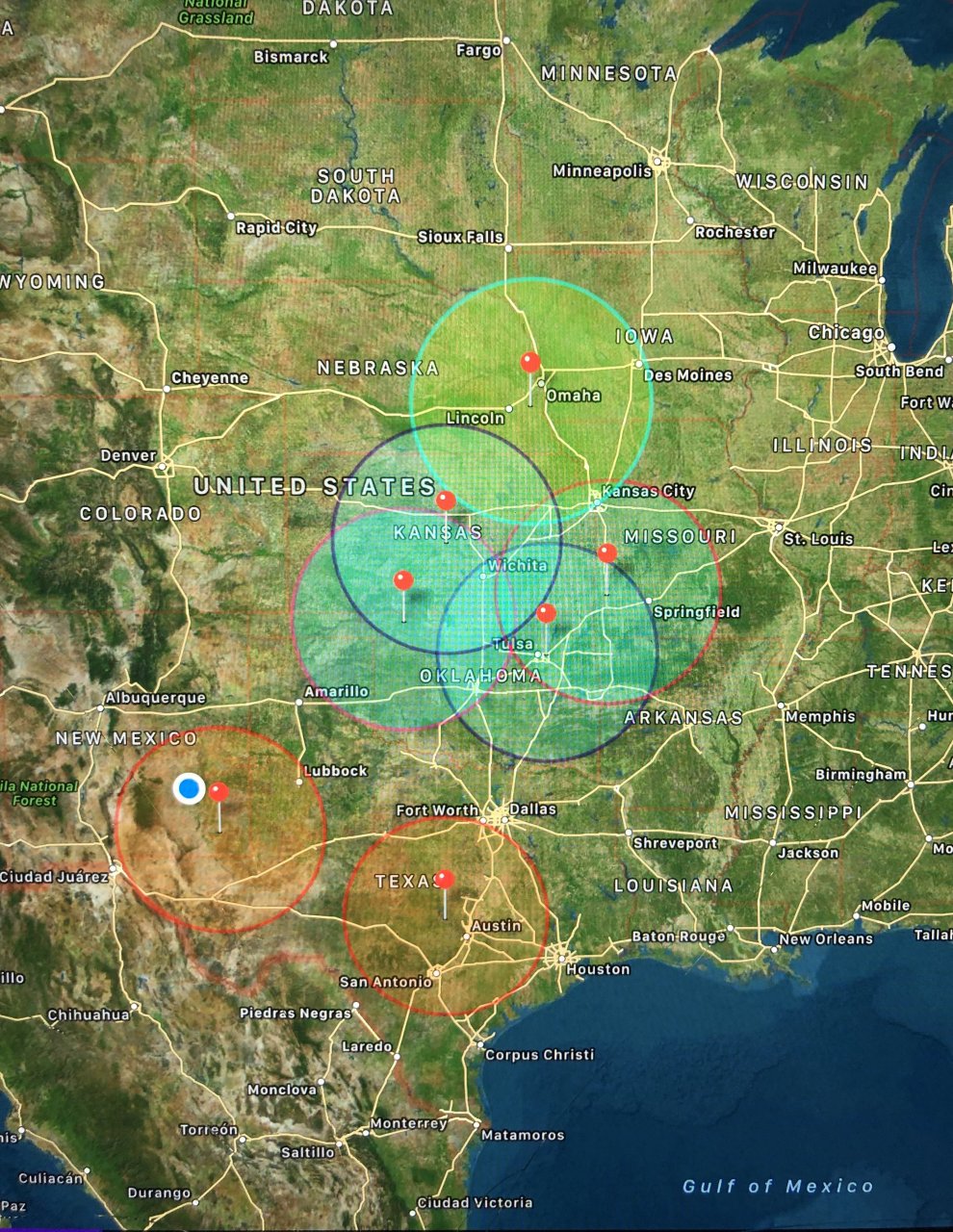

    I run an app on my tablet called Radius on Map so I can see where my Ag exempt starts and stops.

    Remember an “air mile” is a nautical term that equals 1.15 miles. Air mile does not mean how the crow flies. When I was local I varied a print out with a 230 mile diameter circle around home base.

    I use Google Maps. I just drop a pin where the load Origins and choose Measure Distance. I can see exactly where on my route I enter or exit the 150 Air Mile Ag Exempt. I will have to check out that app.

    I use it only because you can save all of them.
