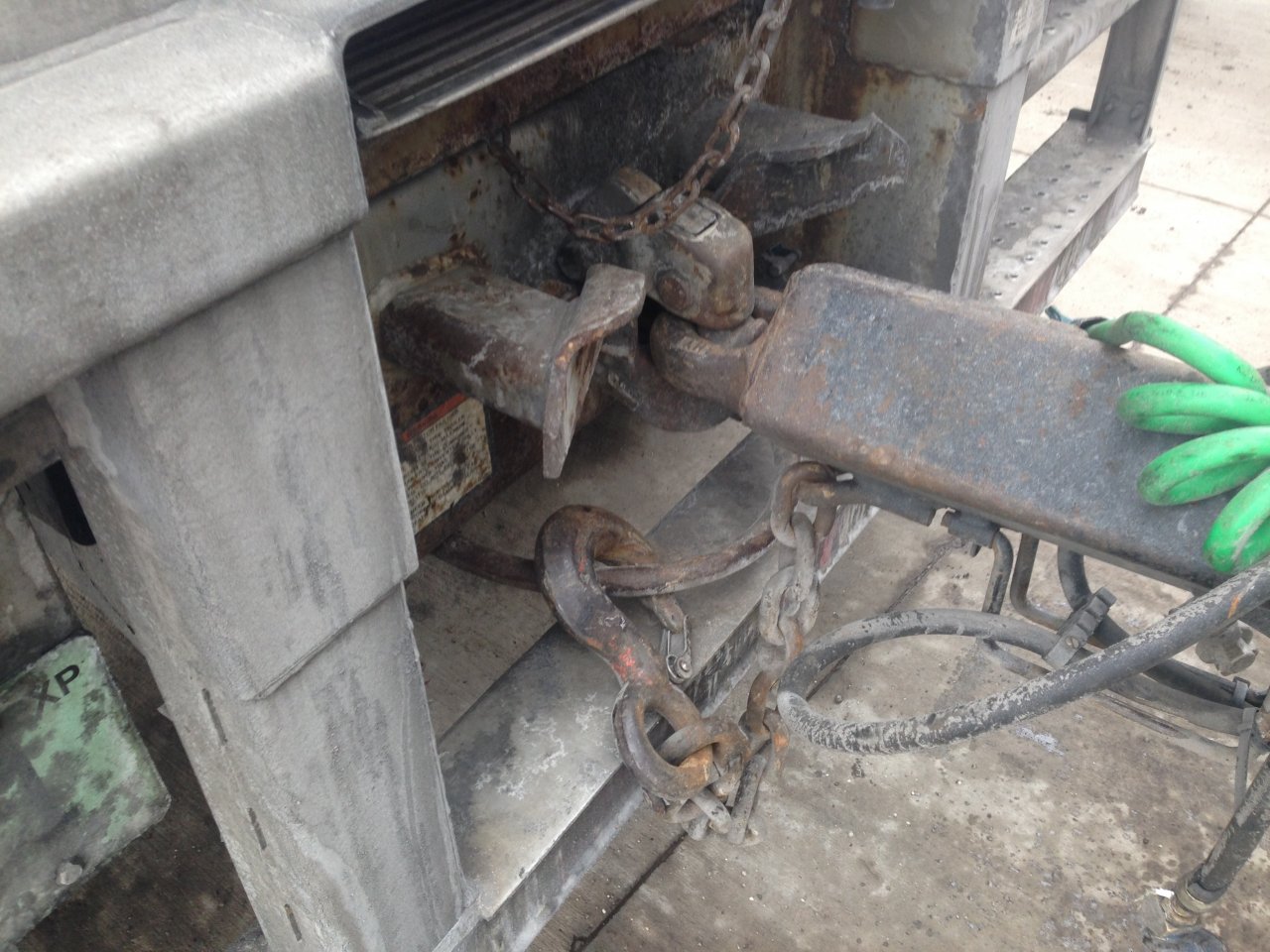

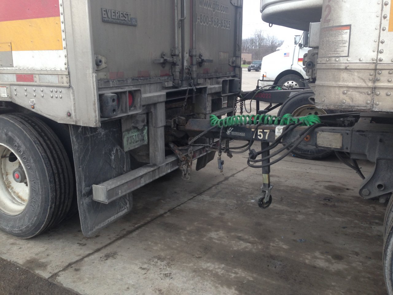

    This is backing a converter up to the trailer. Rule #1 though never actually hook the converter under the trailer unless it's attached to the lead trailer. If you do that it's very bad, because the tounge of the converter will fly up and be stuck and you will not be able to get it unstuck. It's even in the CDL manual to never hook a converter unless it's already a fixed to the lead trailer.
    There's the tong that's it hooked up to a tractor

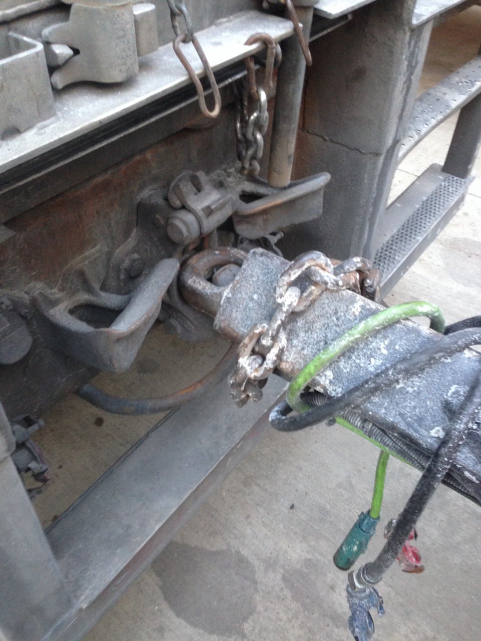

    This is what it looks like on a trailer:
    See this one was good I was able to back the trailer right underneath right into the tong of the converter dolly, it doesn't happen every day LOL!

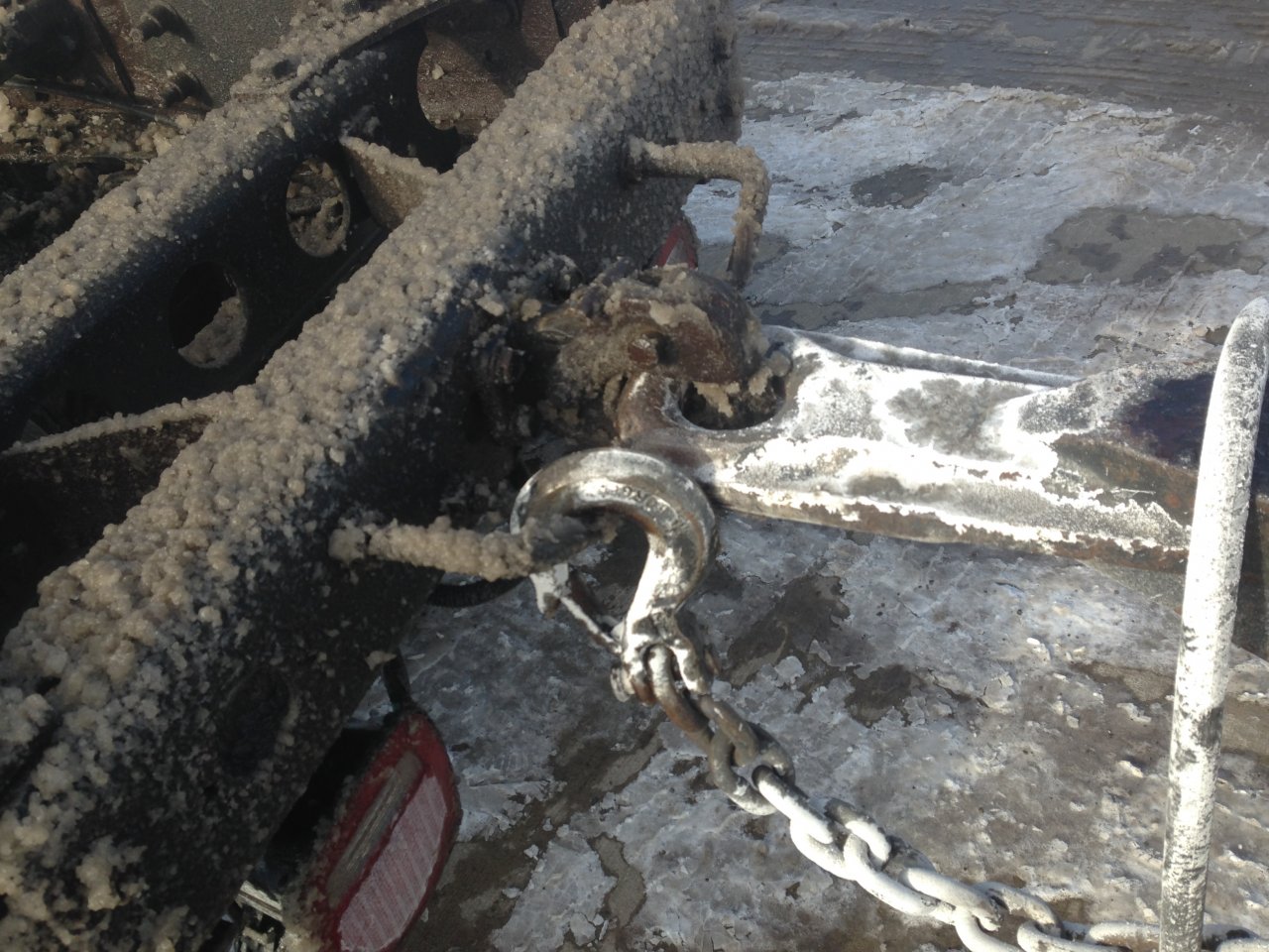

    Don't forget to lock your pintle hook. :p
    BTW, if you do manage to get a dolly fifth wheel coupled to a trailer without it being attached to a lead, it's not a real big deal. Just use the landing gear to raise the trailer and get any weight off the dolly. That will unbind the fifth wheel and allow you to more easily unlatch it.
    Don't ask me how I know. ;)

    If you bump your con gear too hard and it latches itself to the back trailer, I usually get really close with my front box, use the safety chains on the dolly, hook those to the safety bar of my lead trailer and I yank that mothertrucker out. Those dollies weigh 2k lbs, and even if you displace the weight by cranking the gear down, those dollies are a pain to move by hand.
