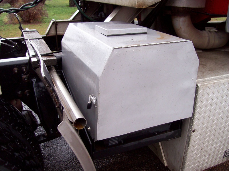

    For those interested.
    It cost me exactly 2 gallons of unleaded to not idle the truck last night in the 28 degree weather in NM. $6.71 to be exact:biggrin_25525:
    Figure it would have been @$40 to idle the truck, so over $30 saved.
    Ran the portable heater and hooked the batteries up to the generator to keep them topped off.
    Martin

    Flawlessly in a word.
    Ran it yesterday, and today down here in Eloy, Az.
    Cools very well indeed, is quiet, and have yet to get any water out of the built in water tank. I guess running the truck with the ac on prior to stopping draws the moisture from the air, making it so that the portable ac unit can just cool and not dehumidify.
    Here is a link to it on Lowes website.
    http://www.lowes.com/pd_367199-3761...llar|1&storeId=10151&rpp=24&searchQueryType=1
    Martin

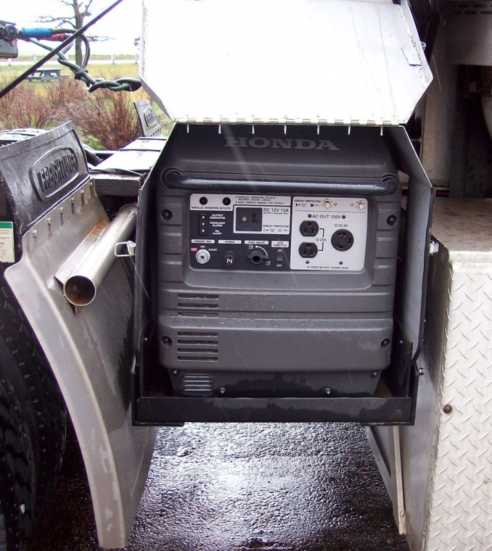

    Quick update a couple of 85-91 degree days.
    Spoke to a guy here last night that was talking to another driver with his concerns. Apparently he put some trash into a dumpster and saw my German Shepherd in the drivers seat looking out. He said it was obvious that my truck wasn't running, and it was 91 degrees outside! They were both getting pretty close to banging on the truck door and going inside the truck stop to page me when they saw me walking back to the truck. He said he couldn't even hear the Honda running, as he was "listening for an APU" I had to show him the setup last night for him to get his head around it all.:biggrin_25523:
    The EU3000 ran for 11hrs yesterday, on 2 gallons of gas. AC in the truck set to 72 all day. I had the throttle set to "econ" which lowers the RPM's considerably when not under a load. I also had the batteries hooked up to the 12 volt outlet.
    Been set like that since Friday afternoon, so I had 4.5hrs Friday, 11hrs yesterday. Imagine my surprise when my low voltage disconnect started beeping at me last night just before bedtime!
    Started the truck for 1/2hr to charge the batteries up then headed to bed after reading the owners manual for the generator.
    Here is what I found regards the 12v dc outlet:
    "Econ throttle switch OFF: 12amp output"
    "Econ throttle switch ON: 4 amp output (Do not use AC output)"
    Oops:biggrin_2555:
    Looks like I should have read the manual a little more than I did huh? Today will be with the Econ turned off for a while for me to charge the batteries a little.
    Will update later, but so far, I believe it to be the best $2500 I have spent on any truck I have owned.
    Martin

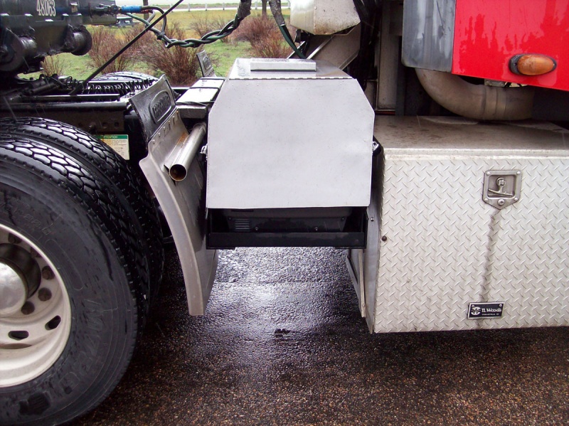

    Happy ya made the decision ya did on the genset.
    Great choice and VERY NICE instilation as well!
    Laughing all the way to the bank I recon too!
