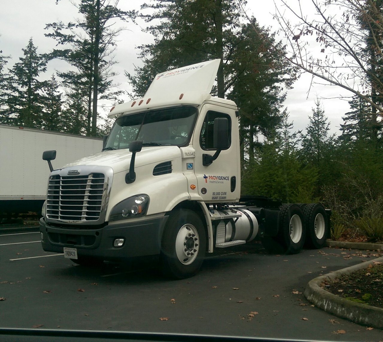

    That's the one thing that absolutely drives me crazy! Why would they design it to downshift 2 or even 3 gears and essentially redline the engine??? I figured out to keep it in manual mode once I hit highway speed because of our hilly terrain around here, and I only switch back to auto in heavy traffic or in town.

    We have full manual control in that setting .
