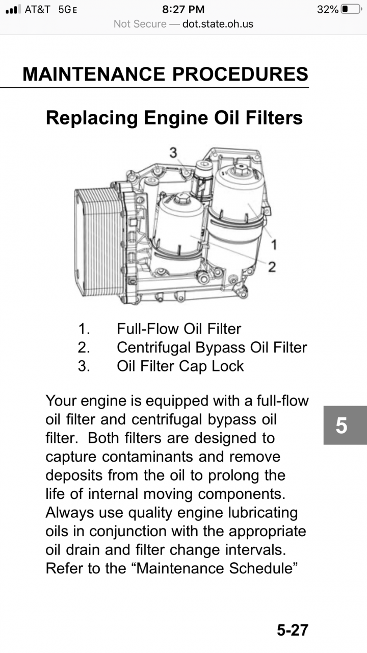

    Why? It’s no different than putting a bypass filter on an old engine. I’m not familiar with Cummins or Detroit, but my Paccar doesn’t have regular spin-on filters.

    Here’s the filter housing on the MX13

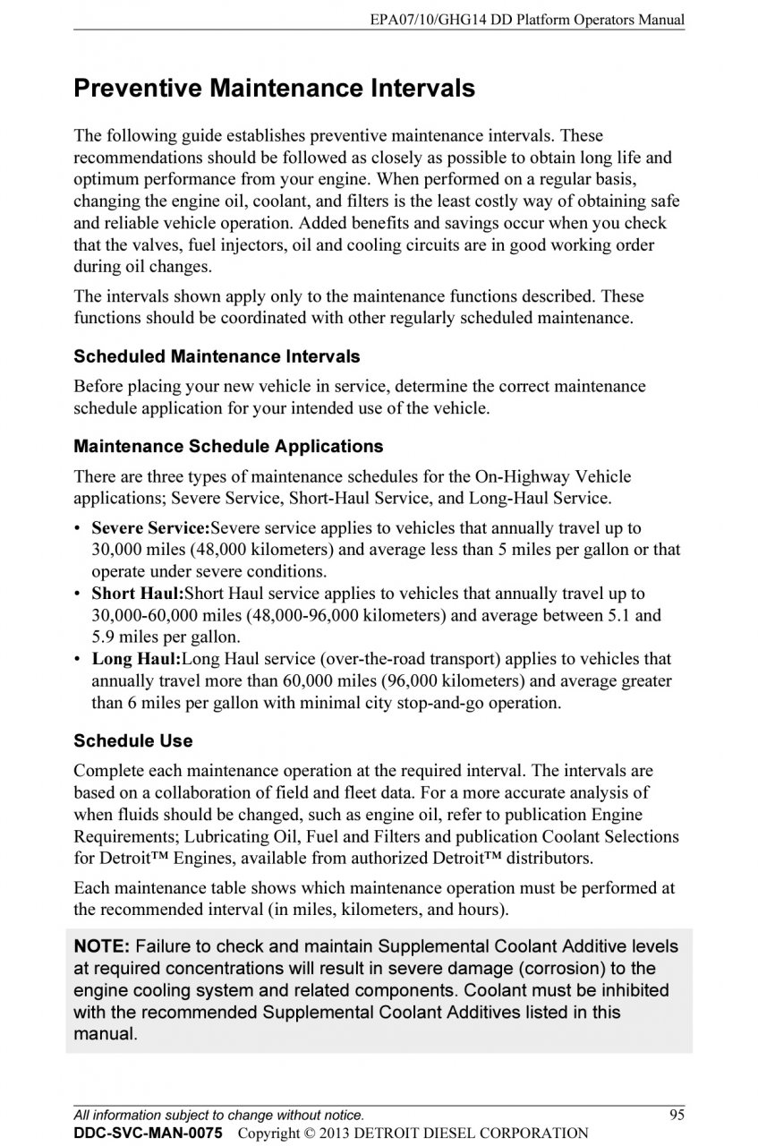

    There is no reason to be shocked by the engine manufacturer oil change recommendation. You have to pay attention to what they’re telling you. Don’t just breeze through the manual. If you think they’re telling you that everyone should change their oil every 50,000 miles or higher, you clearly did not pay attention.
    On the DD15, there are three categories for service: Severe, short haul, and long haul. Each one of these will be further broken down into miles and engine hours. You go by whichever comes first. Some engine manuals will also include the “time” the oil has been inside the engine. All of these are intended to protect the engine from damage—but you have to pay attention. Understand what you are reading. If you cannot do that, then just change the engine oil every 5,000 miles and forget about it.

    If you run an OPS or similar bypass the oil won’t break down as fast and it will stay cleaner. That’s basically the technology that has trickled down and is finally making its way to the OEM’s. Also, I’m running 10-30, not sure what the other two call for now.
