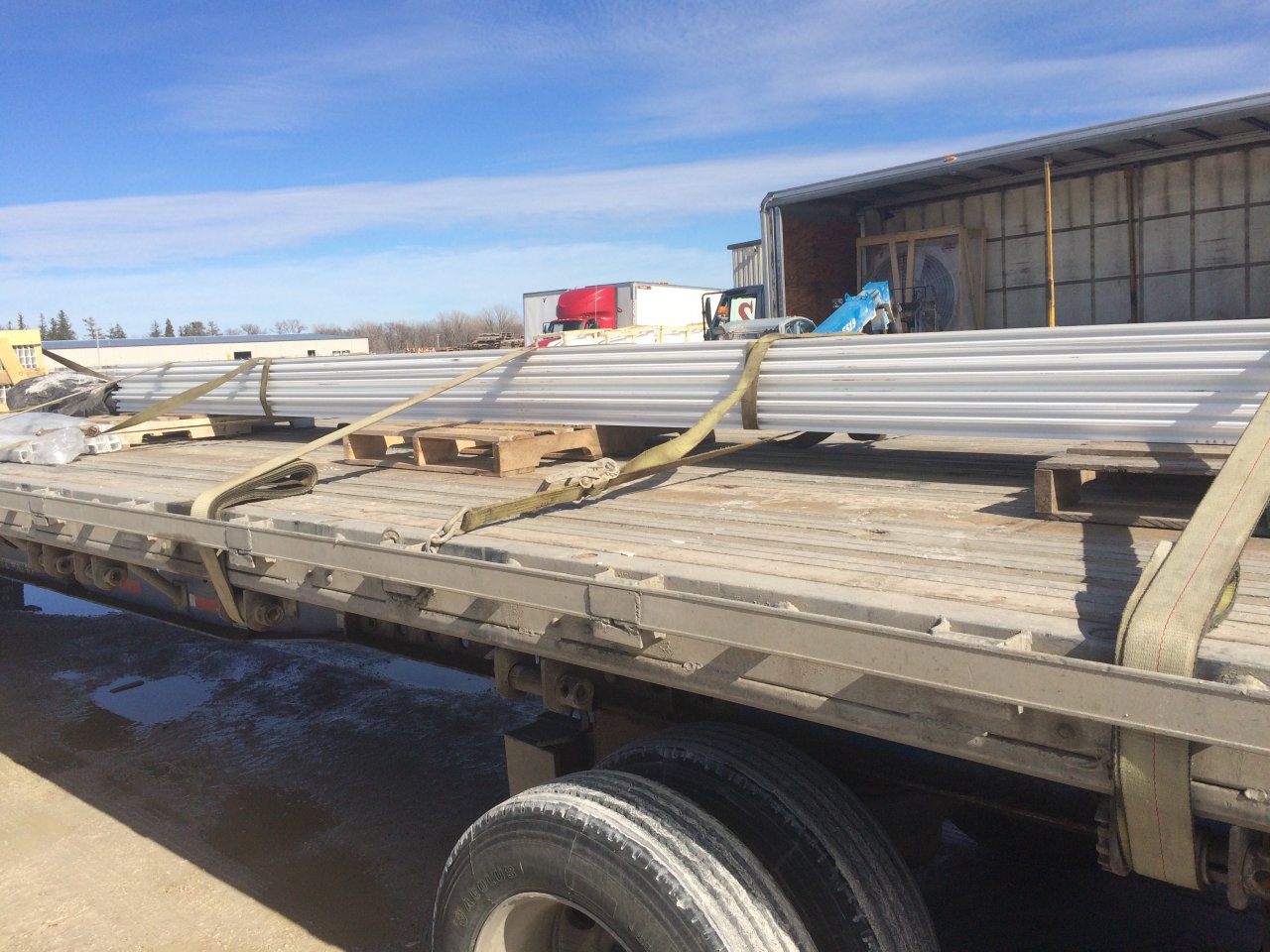

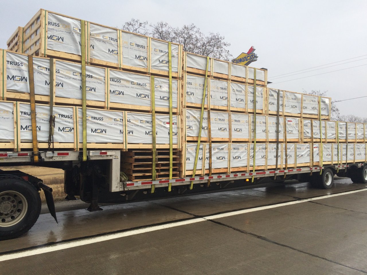

    Depends on terminology. I'm used to a belly strap going in between layers. Like here:
    Choking a load is going all the way around it, to try to make a bundle of pieces stay together. Like here:
    Chewy352, street beater and Bo Hunt Thank this.

    We have very generic terms
    Cross deck
    cross deck choke
    cross deck belly
    same side
    same sids choke
    Same side belly
    Theres a few goofy ones like cross deck pass under but really thats it. I really want load chokers, but i dont think there legal in the us yet...
